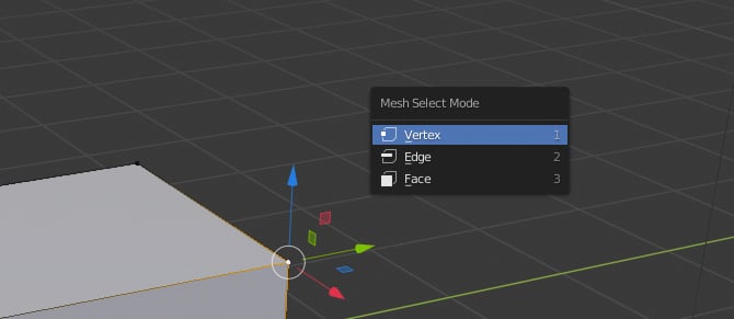

Is it not possible to just change the shortcuts? I find Ctrl+TAB to be blazing fast compared to 1 2 3…
also 1 2 3 I use for front/top/side view and that is golden btw.

I just tried to add the mesh select modes to quick favourites. Not possible.
I can turn on emulate number pad, but I can’t reassign ctrl + tab for mesh select mode when I have emulate number pad on. (not without using Zebus3d’s addon)
I don’t understand why we have this behaviour with such a vital part of the workflow in modelling?
Especially when a large number of the new creators laptops at CES seem to have no number pad.
Well, we’ve got an issue with all those pie menus.
They seems to be hardcoded
https://developer.blender.org/T68793

recently I’m on a short keyboard, so I use emulate-numpad, so to work more comfortable I got the custom shortcuts:
1, 2, 3
for the ortho views, and alt + 1, 2, 3
for switches between vertices, segments and faces …
and surprisingly I am discovering that my workflow has increased and is pleasantly more comfortable.
