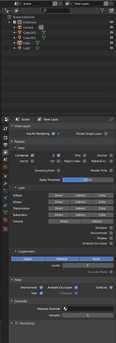

Which settings do you have in blender? Can you send me a screenshot of them (especially the layernames). With the new version of the cryptomatte plugin in Nuke it should work even without the Metadata node…
So I think that there is something wrong with you Layer names in Blender.
Here are the settings. I didn’t use any layers. Just default stuff.
Can you please re-download the plug-in from PsyOp? They merged a fix I provided yesterday. Then try again in Nuke if that fixes it. If not, please consider to provide a simple blend file for testing the problem.
