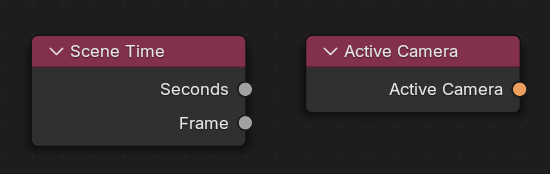

  • We have no way to override existing contextual input nodes like Mouse Position, Active Camera and Scene Time. Being able to override tool inputs like mouse position and viewport transforms would be especially useful when we want to turn an edit mode operator into a modifier.

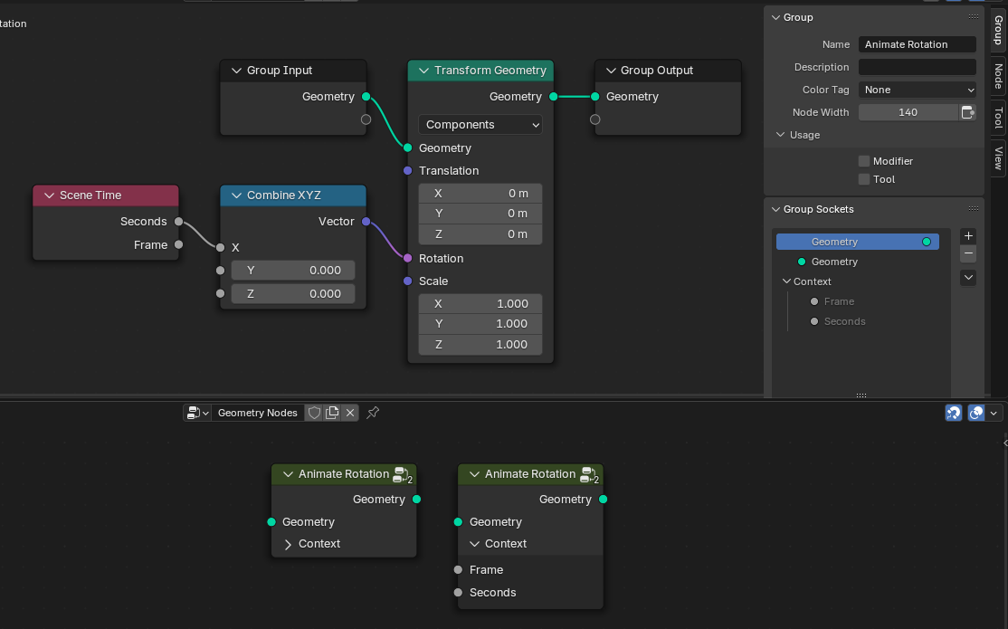

For example, in the image below, the node group uses a Scene Time node which outputs information retrieved from the current evaluation context. The group automatically gets new inputs in a “Context” panel that are derived automatically. They are also grayed out in the side bar because they aren’t editable. The Group node also shows the context input panel. By passing in a value for the “Seconds” input explicitly, one could overwrite it. By not passing in anything, the value will be retrieved from the context.
If the root node group has context inputs, those will also be shown in the modifier, where one can then also decide to either override the input.
If the same context input is used in a node group multiple times, it is deduplicated and only exposed to the parent once.

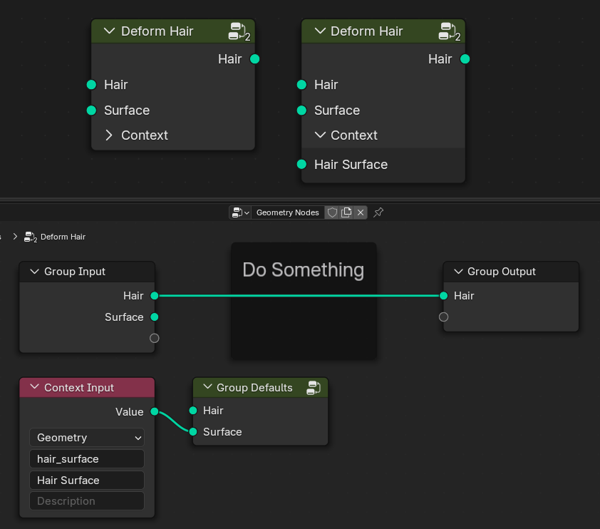

There is also the question of whether all the context inputs have to be in the “Context” panel or if the node group author is allowed to interleave them with other inputs. For example, hair node groups often need access to the surface geometry. This can often be retrieved from context, but it still makes sense semantically to expose it as a normal input.
Currently, my stance on that is that all context inputs should be forced to stay in the separate panel which Blender manages automatically. However, the user can manually create a separate group input that uses the context value as default value. In the Group Defaults node proposal, that would mean that the Context Input is linked to the Group Defaults node.

Relation to Group Input Defaults
In relation to group default values.
This sort of design would do the job fine IMO
Edit*
it was proposed also here
Visually it makes a lot of sense, is more intuitive, than separate nodes :slight_smile:
