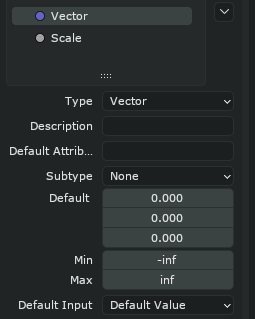

  • For some primitive types (e.g. integer and vector) one can have a single value as default, or choose from a hard-coded set of fields, including e.g. the position, normal and index field.
It isn’t possible to use arbitrary values as defaults for any socket type.

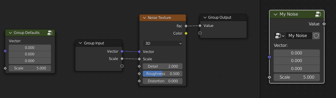

There can only be a single (active) Group Defaults node. The node has an input socket for every input of the node group. The node shows the default values for all inputs.

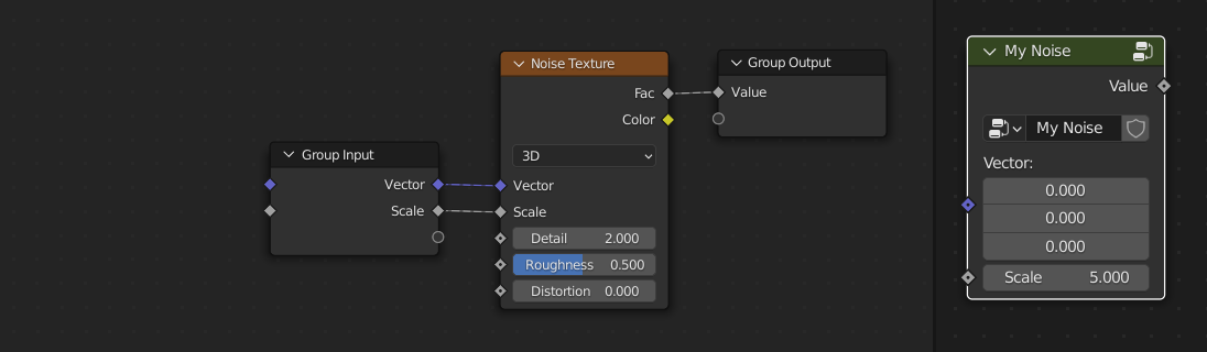

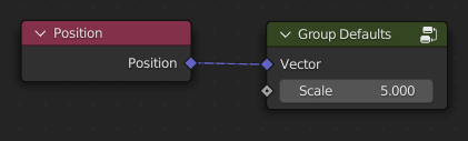

The new part is that one can connect arbitrary other nodes to the Group Defaults node to specify more complex defaults. For example, to use the position attribute as default for the Vector input, one can do this:

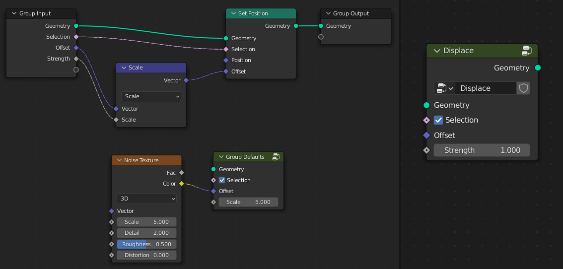

Another common example would be to use a noise texture as default. For example a simple Displace node group could be build as shown in the next image. It’s more convenient than before because it uses the noise texture by default, but can still be customized by passing in a different noise.

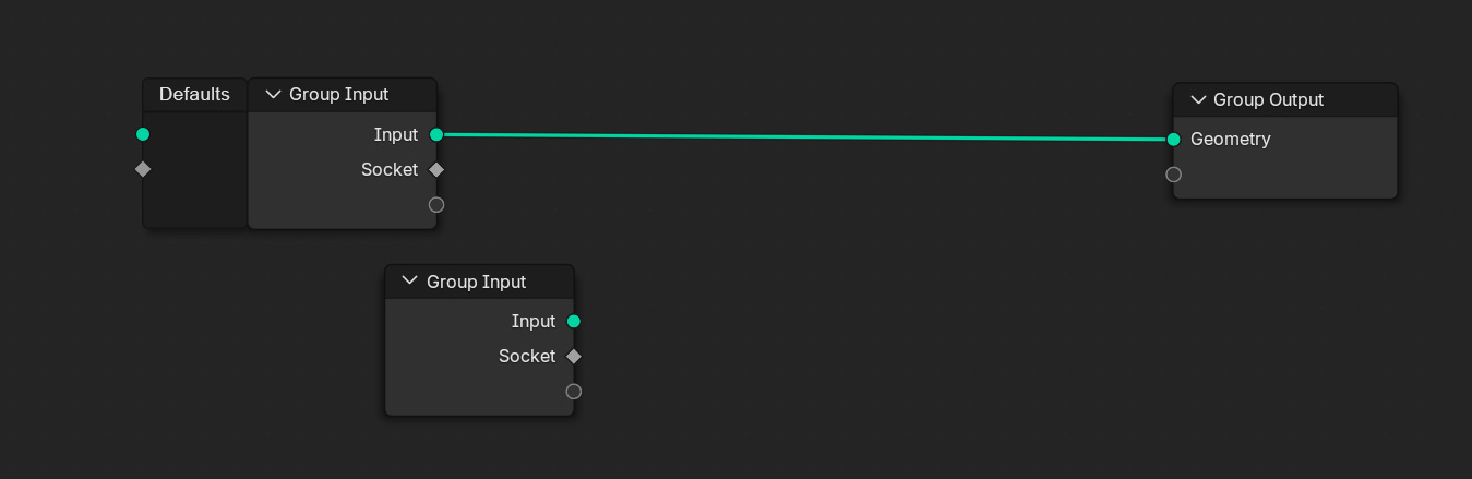

UI-Wise, the elegant way this is handled in some of the game engines is that the input node, which brings the data from the parent node level has inputs of its own.
So instead this:
Which looks quite wonky given that there’s a random, disconnected floating node, you’d have something like this:
…where if the input of the group input node input socket is left empty, then the value in the node group properties is used:
{7BBA4671-696E-4607-8B39-C0AFAAF6B6ED}
And if the group input node input socket is occupied, the default value its overwritten by whatever is fed into that socket.
This would also mean the input sockets of the group input node would not need to have default values displayed right in the node, as they would be present in the Group sidebar, and therefore it would not throw off the alignment of the output sockets of both new and existing group input nodes.
The issue here though, would be how to handle multiple group input nodes, which are currently possible. What will probably end up happening is that we’ll end up with sub-par solution like dedicated defaults node, because it’s now too late to fix the flawed design of multiple group input nodes being possible, which was consequence of blender not having named reroutes. It’s sad that new, modern design decision are often limited by the bad legacy ones :confused:

We thought about having this functionality in input nodes. I’m not really against it, it just has some problems as you already noticed.
There can be multiple group input nodes and there is not a single active one (like there is for Group Output nodes). The other problem with that is that then it might be harder to find the group input nodes, because they are not at the “beginning” of the tree anymore.
While the design could have been done differently, so that only a single Group Input node is allowed, I don’t think that would have actually changed the situation much. If people would used named reroutes as you mentioned instead, you’d still kind of end up with a single node somewhere that would be used to specify the defaults. Just that it is the single Group Input node and not the Group Defaults node. That said, it seems unlikely that the design for Group Input nodes is changed, because it does not seem worth the trouble.
I feel like it’s better to have a single place to specify these more complex defaults instead of mixing those with the rest of the node tree. There they can also get in the way of e.g. creating a group with ctrl+G.
