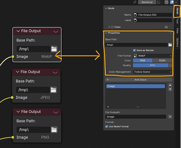

Just so you know, the file output type can be changed per file output node.
The setting can be found in the Node Properties
in the side bar (Opened by pressing N
) while a file output node is active.

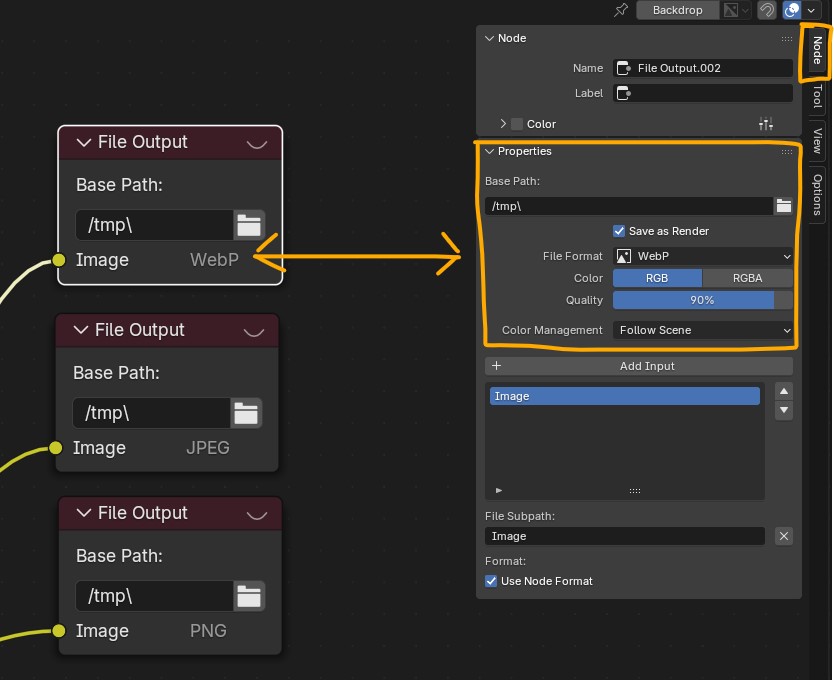

Ah, well then, TIL you can modify Blender’s File Output nodes on an individual basis! I’ll give it a whirl and see if there are any challenges to it, but that seems to be the missing link. I was unaware that they had been decoupled from Blender’s main render settings.
