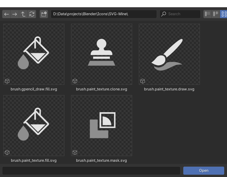

That is a good question. The renderer we are using in Blender is quite simple and basic. There are some SVG features that it doesn’t support, like text, filters, etc.
It is easy to test though, we use the same library for rendering SVG previews in the Blender File Browser. So just use Blender to browse to your folder in thumbnail view. If it looks okay there it will work fine.
Seems to look fine.
