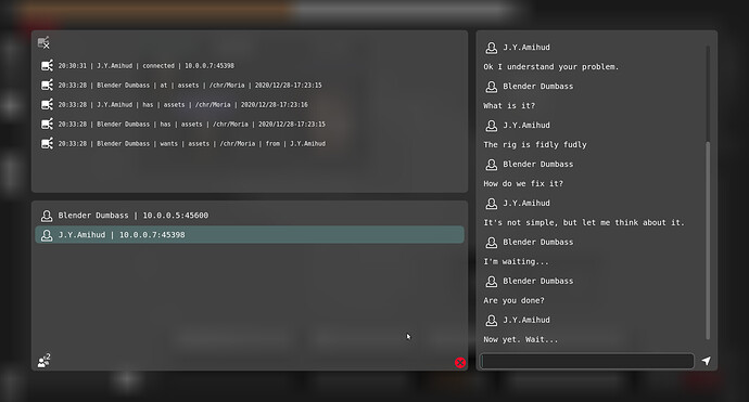

Early Multiuser UI
The UI of the multiuser is a challenge because it has to work on so many levels. For example. This top, left part where it’s the server output. What if you are not on the same computer as the server? For this tiny thing I need to make server send messages, client save them and UI script draw them. It’s 3 different programs.
This whole multiuser system is going to be quite an update. This is already quite insane. But it needs to be even more insane.

Okay so far you can Edit your username, the language (which are easy to make text files), theme (which is a folder with an easy to make color data text file and a pack of png icons), the blur, and the amount of roundness. Maybe people want squares everywhere.
And yes, I did use a scroll slider for the value slider, my toolkit is very flexible, I mean round-rectangles are also circles, buttons with the logic of the button, that can have icons in them. This is weirdly flexible way of working.
The UI is almost there.
Multiuser is a very hard thing to do for me. Maybe there are people who are hardcore network developers that can make it simpler and quicker. But I’m a noob. So here you go. Tho there are so cool stuff going on. For example every user will have a terminal output of the server. Ever user. Not only the one user who is running the server. That’s kind a cool.
For the UI side of things. I will need to only make messages. And everything is cool.
The UI is done.
We’ve got the UI of the Multiuser. The place where users will be talking to each other and stuff. Now. This doesn’t mean that the multiuser is finished. I’m far from it. Even this little thing revealed some insane networking bugs I had to fight with. It has to be at least alpha stage ready before I’m going to ship it.
