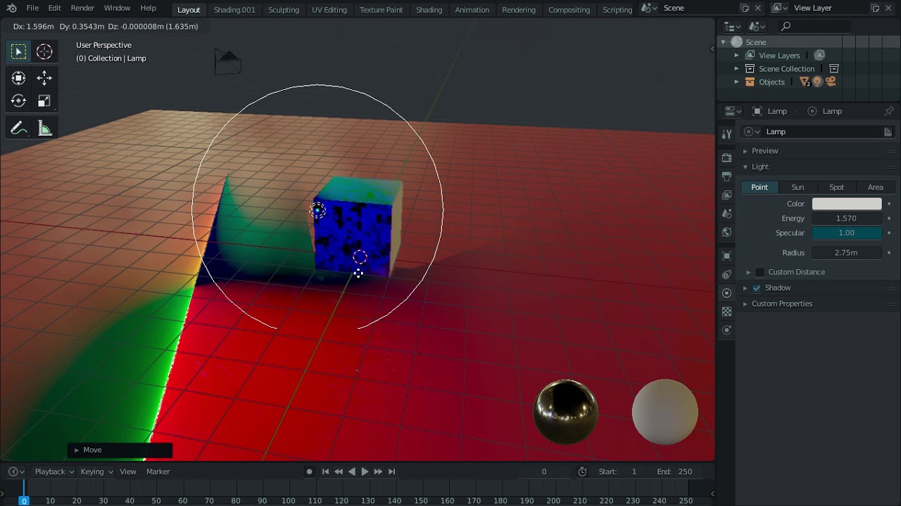

Radeon HD, MESA Linux Gallium r600, Light and Shadows Broken
The purpose of this thread, is to better investigate where the problem is, (I am convinced that it is something really small) and in case to be able to solve the problem.
the videos are from 5 months ago, but the situation until today has not changed

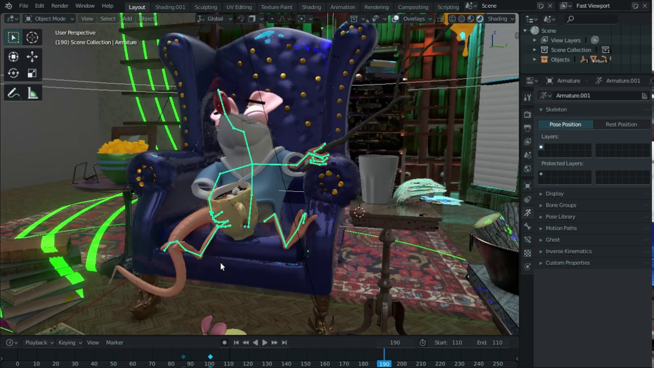

I made a video showing how the mesa drivers work well.
This video was made on a radeon HD 7670m, but out of curiosity I also did tests on a laptop that has a radeon HD 2600 XT with 512 mb ram, a 2007 laptop! and the workaround also works for them (obviously everything is slower, but visually it’s perfect.)
