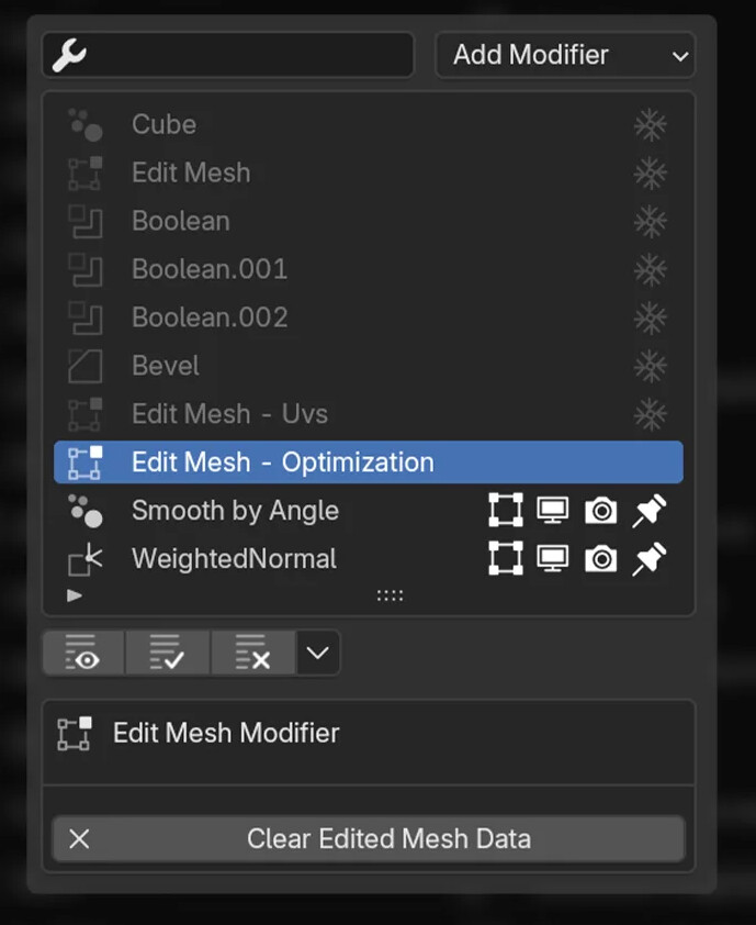

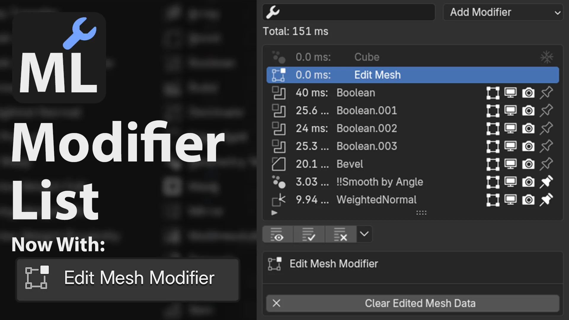

A Mesh Edit initial implementation so that you can layer your modeling edits would be a a gamechanger. At least a poor man version of the Edit Poly of the you know who…! Imo node based workflows for advanced modeling is overkill. Modifier stacks workflows have never reach their true potential, neither in Blender nor in the comercial software that dabbled with them. Just look at Paul Neale work on both modeling and animation, almost completely procedural just by stacking some modifiers (I would post a link here but it concerns comercial software so…)
Yeah, at least something like Edit Mesh in Modifer List would be great! Still do not understand why its not a option? Every procedural modling software has it!

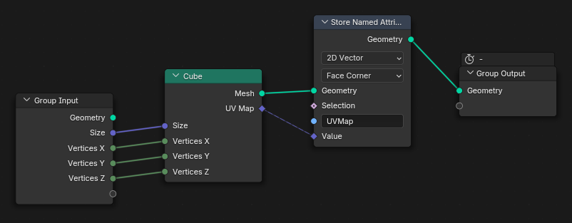

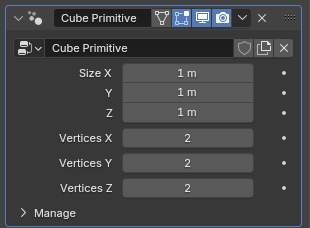

Taking a possible cube primitive as an example,
as modifier it must include UV Map for materials, but when it’s used in node tree, you don’t want to keep storing the UV Map. There were specific reasons to separate UV Map generation into a sperate output socket. in the node tree it’s likely more encouraged just to use “Cube” instead of “Cube Primitive” modifier. It’s questionable if devs want to populate the list with this redundant function.
(note cube primitive is just an example. When it turns more complex then I think there definitely will be redundant node groups for different cases)
Therefore, if a modifier asset must be a group node shown in the list, it may unnecessarily populate the Node tree list a lot?

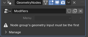

  1. Another thing is more of issues to UI design.
    I hope the limitation that “first geometry input must be the first” can be lifted.
    If a node group is meant to be both a Group Node and a Modifier, this modifier limitation is shaping how node group layout must be designed.

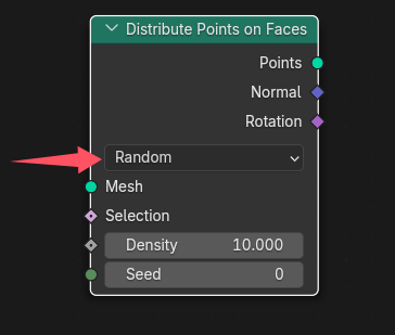

    While this is more of a minor personal obsession, Blender Node design doesn’t always have geometry input at first. (in fact Most of time this may not be the case at all)
    An example is “Distribute Point on Face”. Although the enum input is not exposed for modifier yet, you see it violates the modifier rule already in terms of design. Can devs imagine how the future will look like if all these node group must have “first geometry input must be the first”?

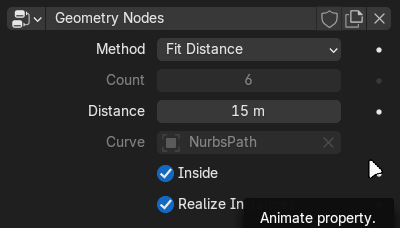

I’ve been looking at what it would take to convert the Array modifier, and one thing that would be very helpful is an option like “Hide When Unused”. It’s really nice that unused inputs are now grayed out, and we have the ability to hide in modifier, so an extra option to combine those would help in cases where a menu enum should switch which options are displayed. Also giving this to panels as an option if all inner inputs are disabled would be even better.
04-29-07-48-32_195
Could be a socket option maybe. Made a quick PR to try it out: #138142 - Nodes: Add option to hide in modifier if unused - blender - Blender Projects
