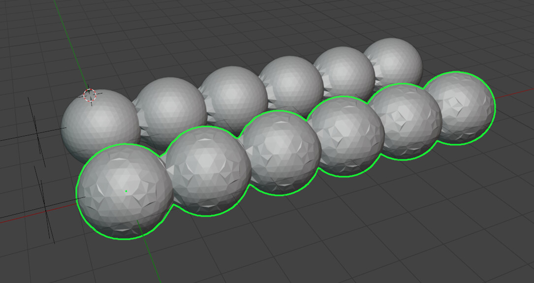

Awesome! Another recreation of the Array modifier was posted a few days ago, if it helps as inspiration or collaboration, haven’t tested it thoroughly but seems quite close.
This is great! The merge control needs to merge only at the intersection of the copies and not the entire object, but beyond that it seems pretty spot on.

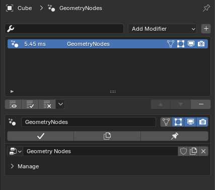

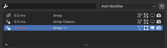

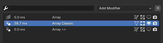

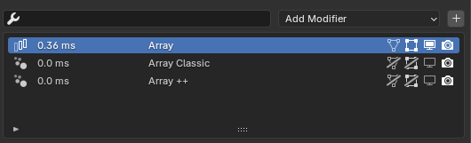

One thing thats a bit concering though, is that the Geomtry node Array is about 100x slower than the old modifier one…
Old modifier
New geomtry node
Even worse with the advance one, taking almost a second doing the exact same thing as the old modifier, only 2000x slower!
I seriously do not see how Geomtry Nodes can replace the old modifer anytime soon with this performance. @HooglyBoogly Is there any plans to adress this?

Are you using Merge? On my end, with the advanced version, that is the majority of the performance drop. With 10,000 cubes and a relative offset of 1 on the X axis, I get a total time of 290 ms. Here’s what the slowest nodes are in this case:
  • 278 ms - Merge by Distance
  • 8.7 ms - Set Instance Transform
  • 2 ms - Realize Instances
  • 0.2 ms - Instance on Points
So actually, most of the calculation is trivial but the array modifier’s merge must be crazy fast in comparison. If I turn off merge the total time drops to 12 ms, and if I skip realizing instances it’s about 9.5 ms.
No, I did not use merge in my tests, but I also noticed that turning it on makes it crazy slow, I really wonder how the old modifier is so effective? Perhaps it only merges the first 2 ones and the last one, the rest just being instances or something?
I think because the modifier only needs to check the vertices of the previous and next copies while the geometry nodes one needs to check every vertex of every copy. That’s one of the big limitations mentioned above.
Interesting that it’s so much slower on your machine even without that, though. I’ll try testing on some different computers and see what’s up.
