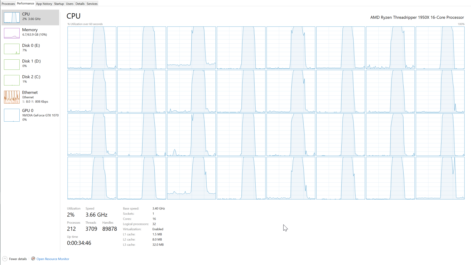

Here some numbers.
Encoding 600 frames of video from 3840x2160 60 fps AVI to 1920x1080 60 fps H.264 MPEG-4 in High Quality and with Slowest encoding speed.
Question is - why some third party tiny software can " just do it " but Blender itself can’t do things same good enough even close?
