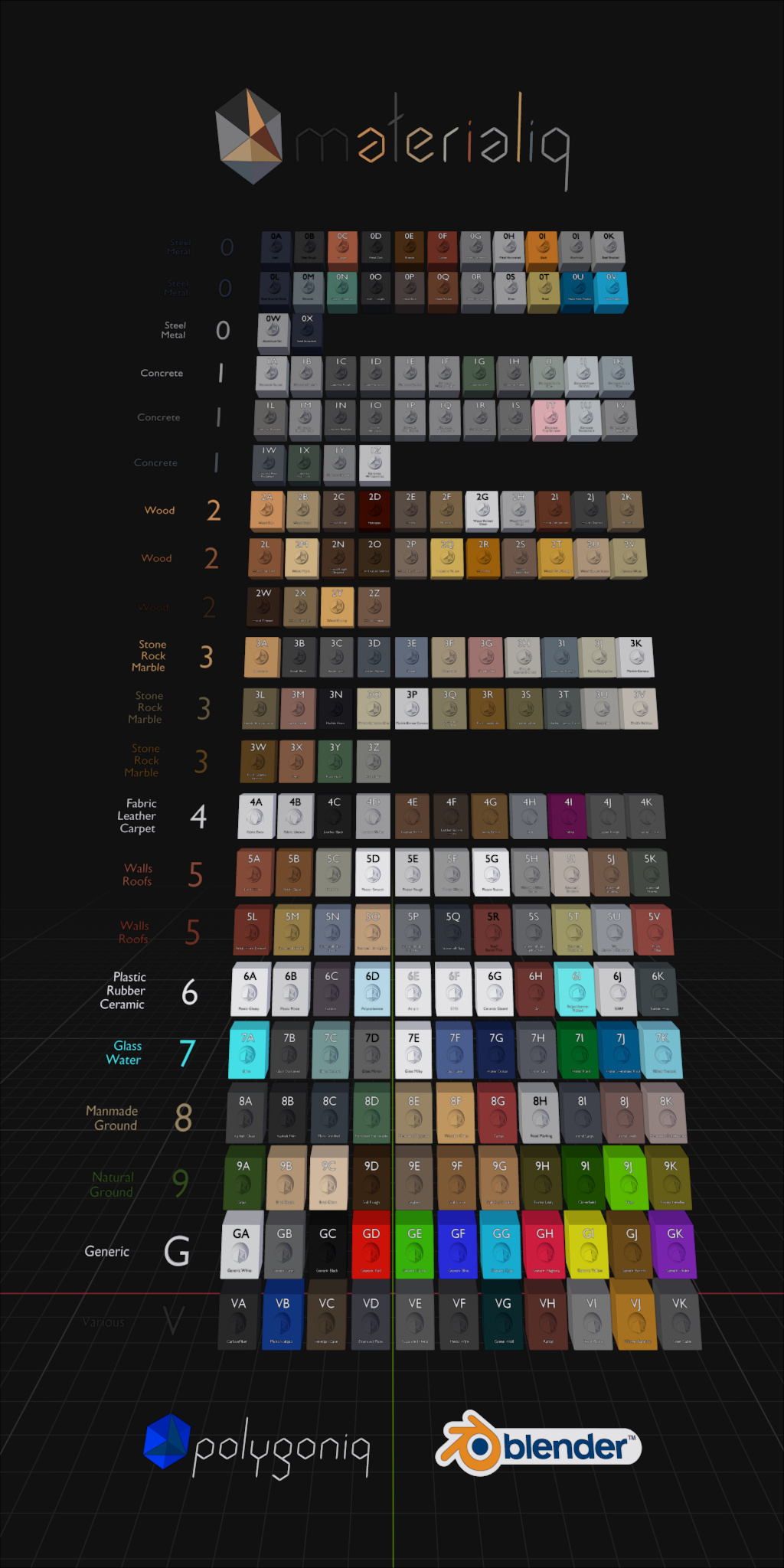

Here you can see a copper material in Solid Shading in 2.79 and 2.8.
I’ve also made an entire material library using this pretty cool feature I plan to release soon and it just doesn’t look as good in 2.80. Especially check Metals at the top and transparent materials in 6 and 7.
