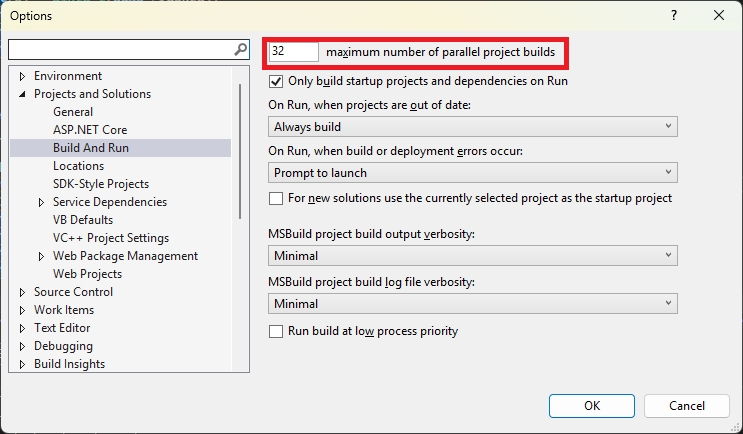

Just a heads up adding more ram will not reduce cpu usage, but personally i budget 2GB per logical core, if you’re running into trouble you can always try lowering this number in Tools->Options
