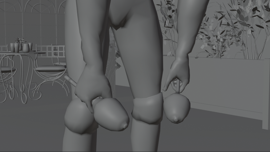

Test scene
Material Flat
Random Flat (here we see blending of the props and backgrounds)
Random Flat rendered using Viewport Render (washed out colors)
