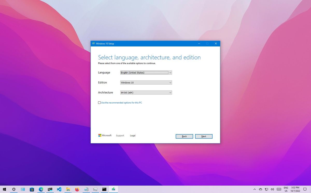

I can see your processor is a x64, so it is compatible with windows 10 64 bit operating system , just find Windows 10 installation disc and switch to 64 bit OS
You can use Google to find instructions of how you can switch to windows 10 x64 bit
But in all seriousness, Windows has a re-install utility, so you can probably just use that if you’re comfortable with Microsoft’s spyware :sunglasses:
Hi, you cant “upgrade”, you need a clean/new install and you can use the same license key.
