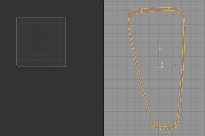

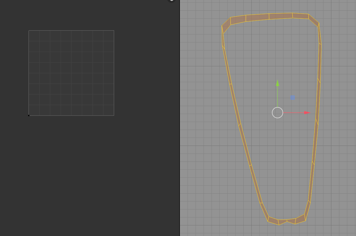

Hi, i have been testing a bit more using the build above it work beatifully most of the time, the main issue i found was with knowing in the uv editor, when was SLIM working and when it was just stop, didn’t get any crash but several times meshes collapsed when i was trying to force weird position others simply by scaling some pinned point (see NB1 bellow)
PIned feedback.MP4 - Google Drive (Couldn’t upload this video here, sorry)
In this Drive link are the blend files with the meshes to test i used.
https://drive.google.com/drive/folders/1qLZXVYHKzbFcf6f6f8h8AcXVwhfZwJxt
NB1: This is something that i saw several times, the simulation simply colapses into the corner
NB2: In the video mentioned the bug happen if there are inverted normals, after keep testing other meshes i find out that the bug its just in the group field, add a randon name of no group there and it glitches SLIM
NB3: This was an unexpected result, in this example in particular slim with vertex pinned and live unwrap in the uv editor work as expected, the normal unwrap with slim didn’t

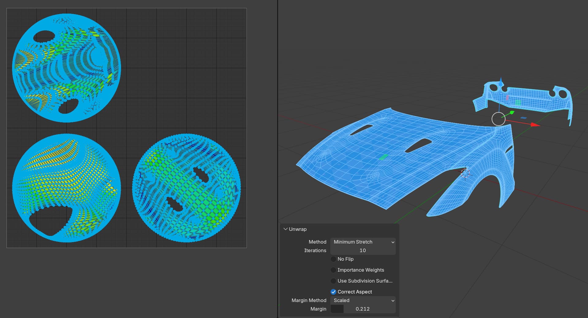

I’ve been getting a weird bug recently where it turns just about any boundary into a circle and tries to fit that. These are flat objects that unwrap just fine with the other methods. It didn’t happen at first, which is weird. Can anyone else confirm? Or am I missing a setting?
Here’s the file:
https://www.dropbox.com/scl/fi/2f3m6xoojvx3p9ktyabma/slim_bug.blend?rlkey=cyx8qiw2ko4kjncqgdf47af80&dl=0

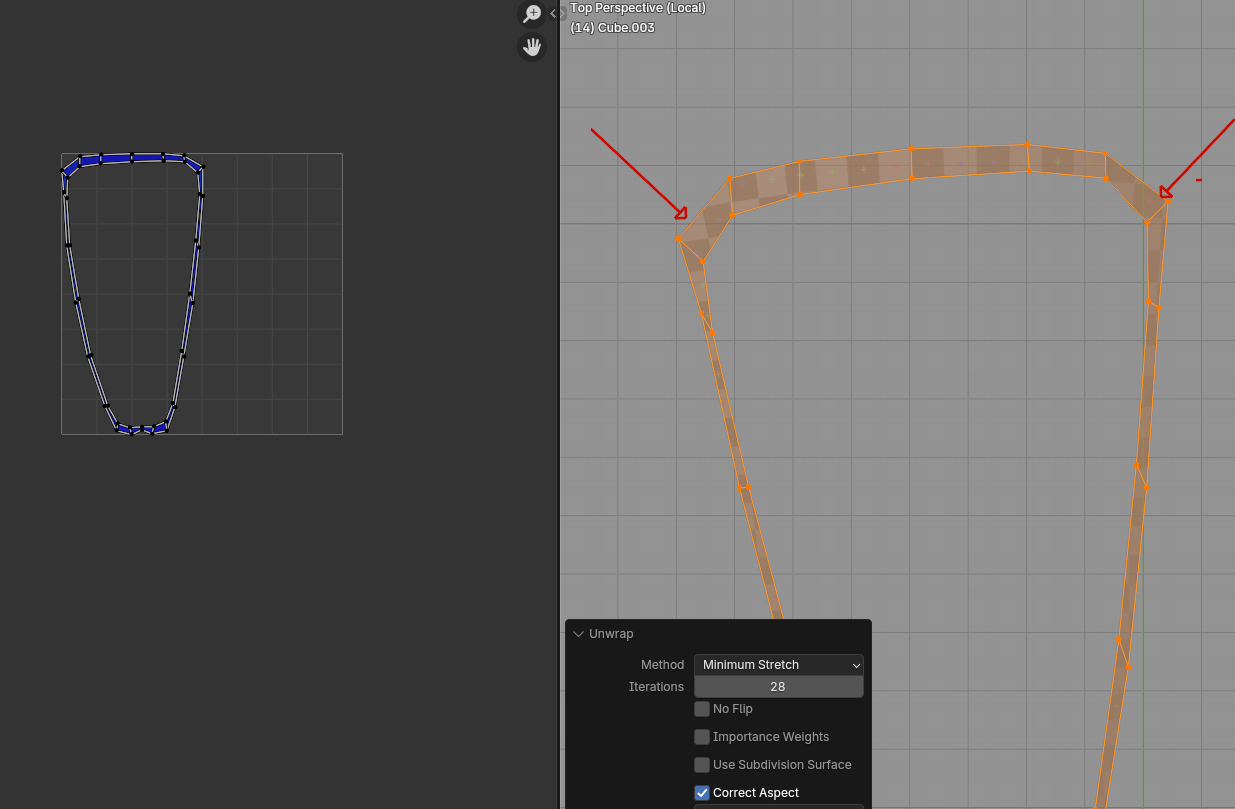

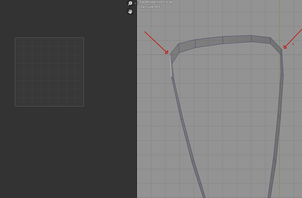

interesting it can be reproduced only by this part of the hood
Moving those vertex in that part seems to fixed it, but it doesn’t work if that part still attach to the en tire hood, ¿maybe an issue related to streached faces?
i can confirm there is an issue solving some parts, don’t know why, maybe it would be a good idea to fill in a bug report in the tracker
as far as i know, that circles are the first step in the solving work for Minimum Stretch , for some reason cant keep solving and stops there.
Ok, it looks like it can be generalized to all meshes with holes. The more complex the hole, the worse the result. I’ve reported this as a bug and proposed the “Fill Holes” option available in the other unwrap methods be added to Minimum Stretch as well:
#129925 - Minimum Stretch unwrap fails on meshes with holes - blender - Blender Projects
