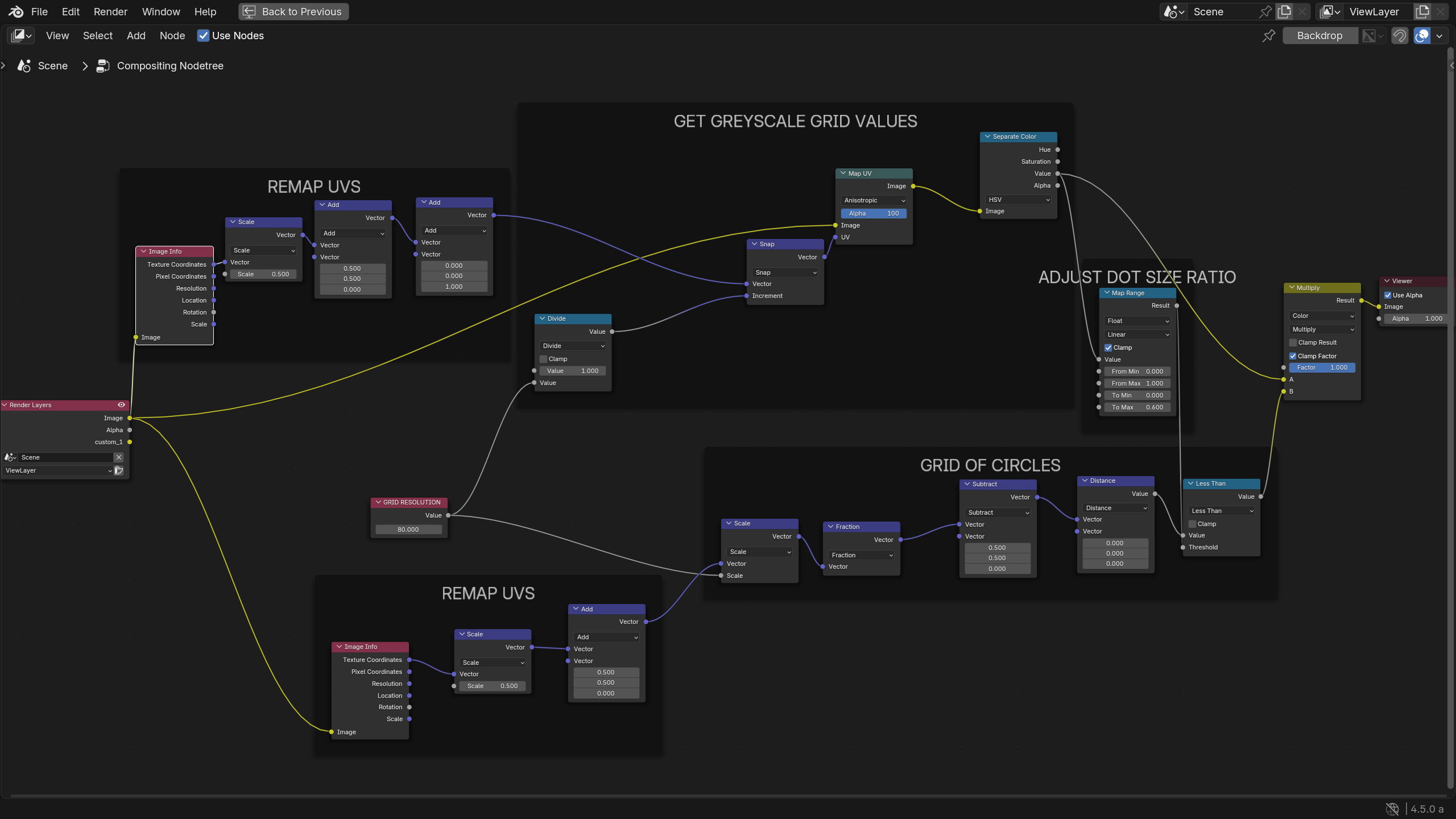

For anyone wondering what I am talking about, there is a new image info and vector math nodes, so you can now do typical shader type setups in the compositor for custom fx.
The halftone dot network as an example:

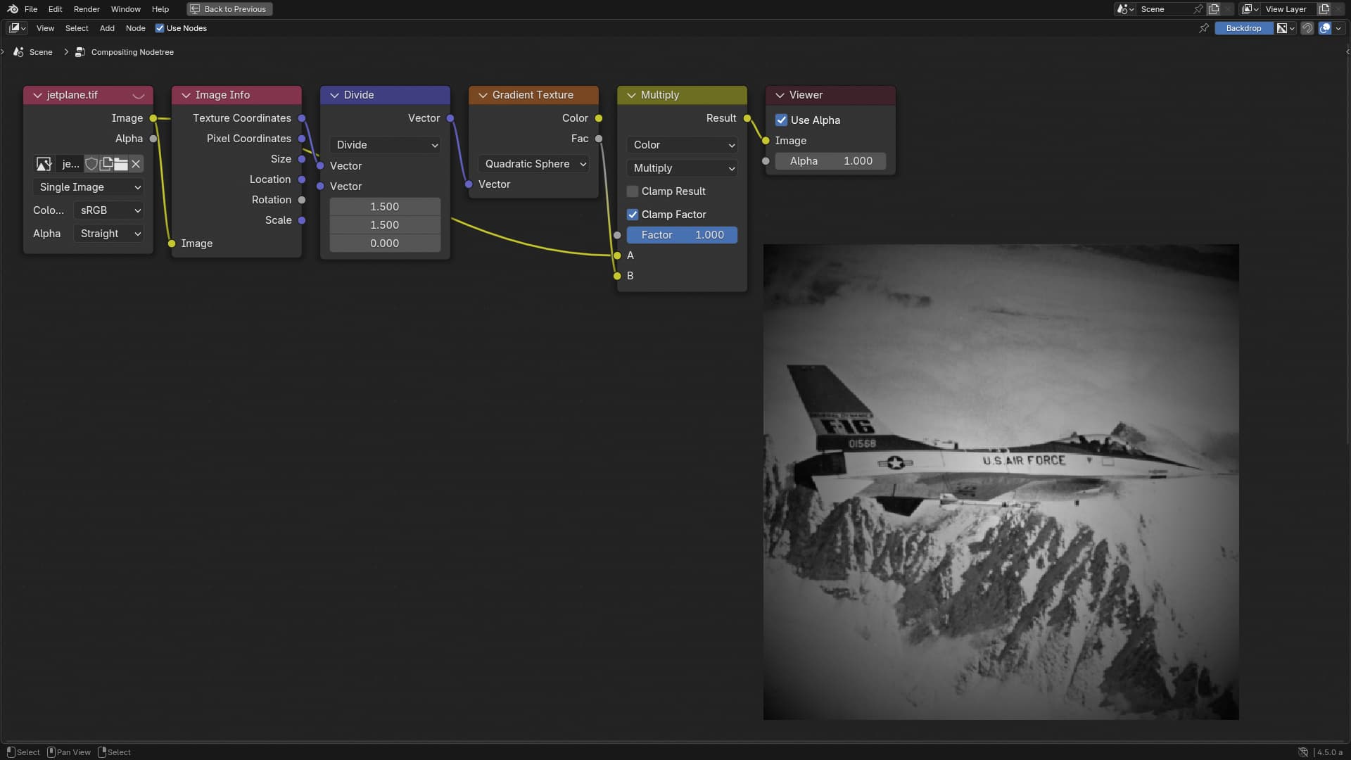

Zero centered coordinates helps with textures and procedural context that are also zero centered. For instance, you can create a vignette by simply using a Gradient texture. Furthermore, scaling is also around the center, which I think is desirable. For other textures, they don’t really have a center, so having [-1, 1] range seems okay.

Looking at your example above, I am not sure remapping is needed in the grid of circles for instance. You would just need to divide your count by two. Furthermore, for the UVs, one should note that the texture coordinates output is also not [-1, 1] in both directions, it is [-1, 1] in the greater dimension and a smaller range in the smaller dimension. So you will probably have to do remapping to support non-square aspect ratios. Just mentioning this so that we consider all cases.

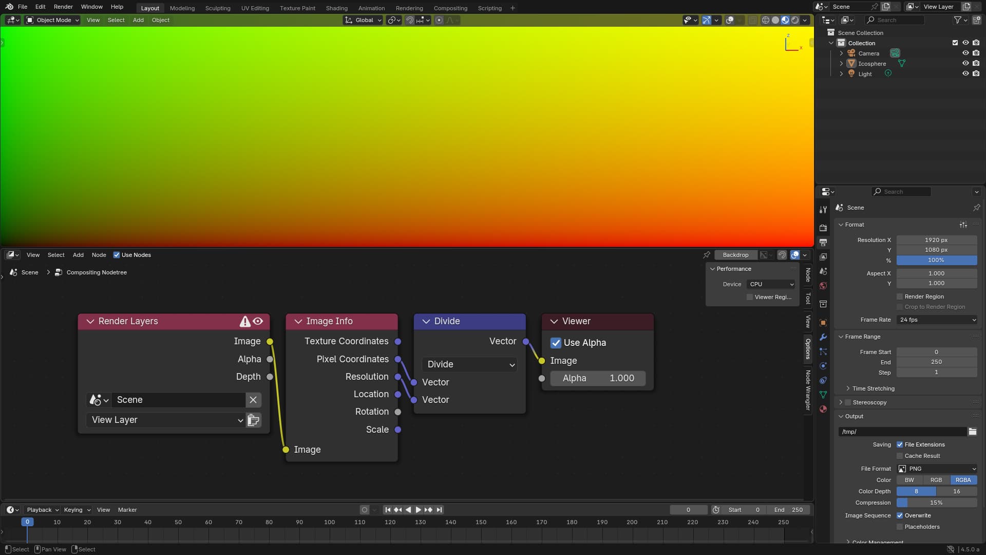

No wonder I have been having issues with get non square dimensions to work, as I thought it was -1 to 1 on both axes. Does this mean that if the screen res is 1920x1080, it is -1 to 1 on the x and -0.56 to 0.56 (approx) on the y? With a 1080 x 1920 res it would be the other way around, with -1 to 1 on the y and -0.56 to 0.56 on the x?
Yes, your assessment is correct. The reason for this is to not have textures stretched when using the texture coordinates. But getting a [0, 1] texture coordinates is as easy as dividing the pixel coordinates by the resolution:

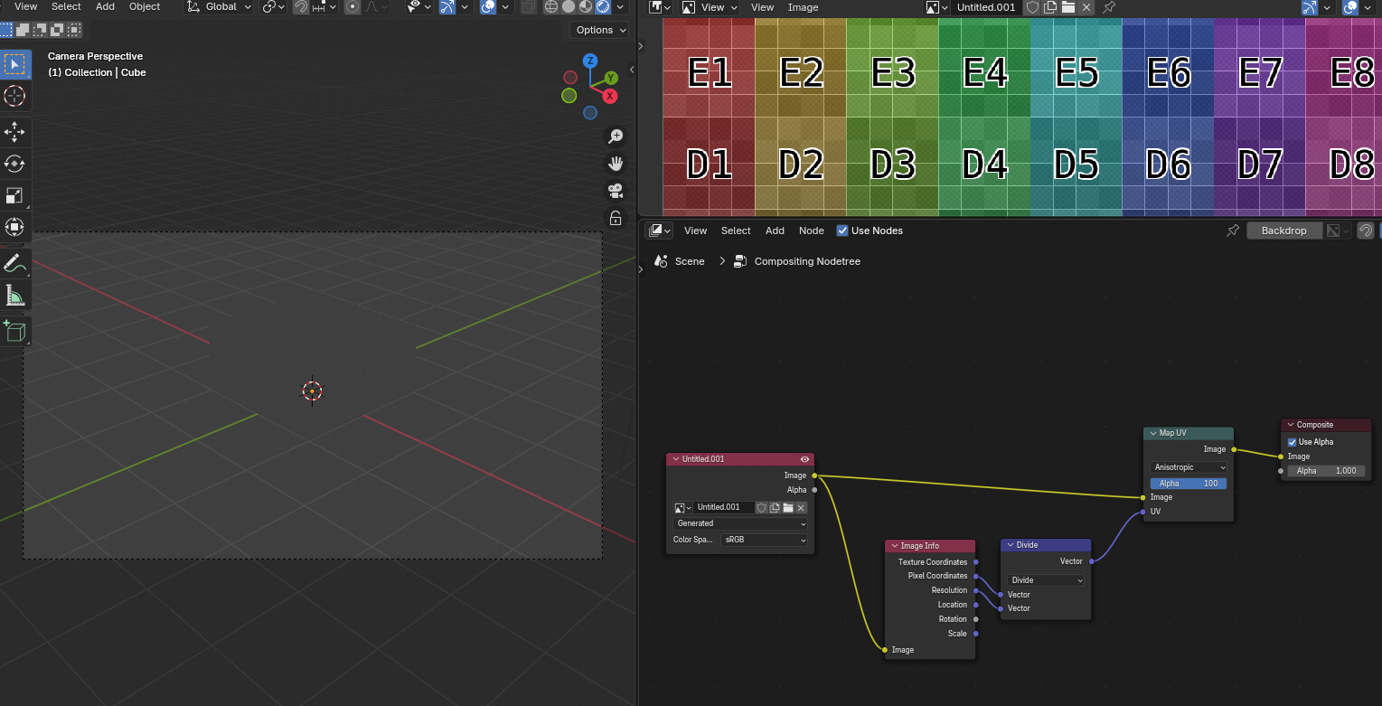

I wanted to try making a distortion effect thanks to being able to get the image UV, but it seems like the Map UV node doesn’t work with Image Info?
Add 1 to the Z component of the vector. See this post for more information as to why this needs to be the case. Real-time Compositor: Feedback and discussion - #717 by OmarEmaraDev
