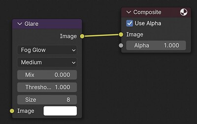

The stack trace was helpful, thanks. I was able to reproduce the crash with this setup:
I’ll fix it within the next few days.
