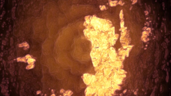

Here are some screenshots of that video:
PS: It’s actually @Raiko doing all the development. I’m only doing the announcement because Devtalk limits what new users can post.

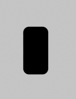

  1. Instead of float scale, I would provide it as exposed vector, reason being that if you want to create rounded rectangle and try to use mapping it stretches rounded parts as well and looks bad. Instead, I want to be able to scale shape only on one axis and have corners keep their rounding perfectly.

Getting rounded rectangle isn’t easy, if I use mapping I get this
Rounded corners get stretch. Instead I want to get this:
scaling should happen before rounding is applied to avoid this, which I’m not sure how to do with nodes
Ahh ok, now I know what you mean, nice idea!
The thing is although the algorithm for computing the rounded corners is actually much more complicated than the output suggests.
It’s definitely worth researching but Raiko probably will take some time to develop an algorithm for a vector scale input.
So I’d say it’s going to come in a future PR, not because it’s a bad idea but because it’s hard to develop.
