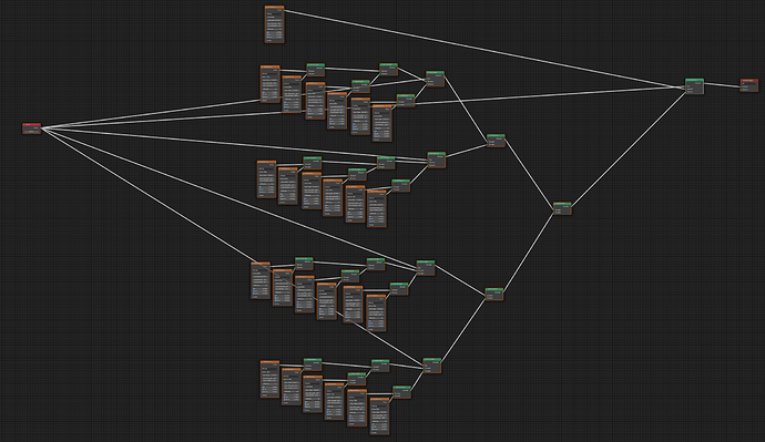

Sorry for polluting the thread. Played a little with the recent linux build.
This is probably the most usless thing to do with Sky texture, but I wanted to test if you can use multiple of them in one scene. And you can:
After adding some roughness to the material most of the sun disks are noisy except the ones that are at 60deg. I don’t know if this is due to my node fun, or its something else. Thought it might be good to post it here.
Hmm, it’s hard to tell without the file, please can you share it here?
Weird that this site don’t support .blend attachments.
sky.blend.txt (633.4 KB)
I noticed you plugged the Sky Texture color output directly into the Shader input of the Add Shader nodes, this is wrong as an Output color should always be connected to an Input color. Said that yes, i still get the issue, i will have to talk with Lukas about that all, thank you for testing.
