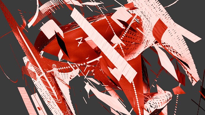

NOW I HAVE A HUGE PROOF!
LEFT 4.1 - 17TH OF NOVEMBER OF 2023 (MUSGRAVE NODE) / RIGHT 4.1 - STEAM DAILY ALPHA
I JUST SAVED AND IMPORTED AND PRINT SCREEN BOTH OF MY MONITORS. A 21:9 IN THE LEFT A 16:9
IN THE RIGHT.

Im a super annoying person even more if im dueling with just a symptom of fear of changing the changes, hehe. The noise is good for whomever uses it, but is not the same thing to work with even more with displacement, as proved in the first print screen.
Rafael, with respect - your postings on this is a train of thought that is almost impossible to follow. It just reads like a general, extended rant of … something.
My work is completely NPR (ā€œanimeā€ style, if you like), and even with that - these 4 images you’re posting are incredibly abstract; personally I have no idea what your goal is for any of that to look like, compared to what it DOES look like.
The screenshot of your interface clearly shows a node as non-functional, so is a failure of the desired outcome of the new noise node. If you believe this is a bug (and given the daily build, quite likely because things go wrong unexpectedly), then please of course report it with clear, easy instructions how to reproduce it (and attach a file, also helps.)

Just testing stuff here based on @Rafael feedback and I found there’s indeed a difference with displacement. Mind that I wasn’t trying to replicate Rafael’s results exactly, just testing something similar to his setup.
Blender 4.1 converts the Musgrave node to a Noise node correctly, and the black and white output looks exactly the same, but the result is clearly different if using Vector Displacement or Displacement nodes. I wonder if the difference is in the displacement nodes…?
