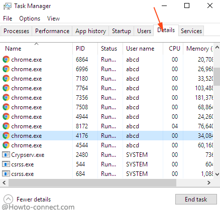

This isn’t linux, but here’s how to do this in Windows:
Hopefully this will help you do the research for linux. I’ll poke around a little more and update this if I find anything.
So you’d set blender to use CPU’s 0 to N-1 and Python to only use N. Note that Blender couldn’t use processor N for any purpose.
Update: If you search for “Linux Processor Affinity” you’ll find articles about how to do this in Linux, however it’s not as easy. You’ll have to be comfortable doing a lot of command line stuff that I don’t understand.
