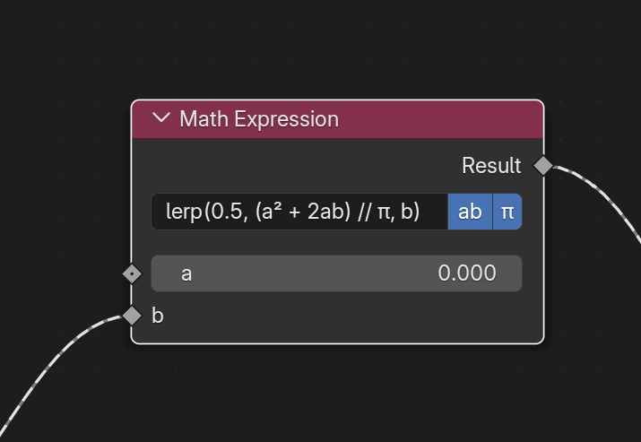

I've created a new 'Math Expression' node
Hi dear contributors and devs :raised_hand_with_fingers_splayed:
This weekend I’ve created a Math Expression node that dynamically adds sockets on the fly, and I would like some testers.
It’s all implemented in Python using the GeometryCustomNode type. (See this archived topic if you’re interested in how I managed to do this.)
How It Works
It relies on Python’s exec(). The math expression string is sanitized and then transformed using the ast module into functions that automatically arrange a node tree (similar to @Wannes’ plugin, but integrated directly within a node).

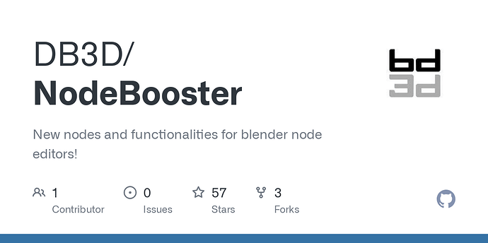

The project is part of the free ‘NodeBooster’ addon, which includes other nodes (such as a Python evaluator node) along with additional features.
Download it on Github:
Documentation
With this node you’ll be able to evaluate a math expression using various math nodes. The variables will be automatically created when you confirm the expression.
About:
  • The following operators are supported: +, -, *, /, %, //, **, and the exponentiation notation using ².
  • Many functions are recognized, such as sin(a), nroot(a,n), lerp(fac,a,b), and many others. Please see the full list in your node editor under N Panel > Node Booster > Active Node > Glossary for function names, their arguments, and descriptions.
  • Macros for irrational numbers are available. The macros Pi, eNum, and Gold can be automatically assigned to their corresponding Unicode symbols (π, 𝑒, and φ), which will be recognized and used. Make sure to press the π button to activate these macros.
  • Algebraic notations are supported (also known as implicit multiplication). You can work with expressions such as 2ab(4ac+π)², where variable names are split into individual characters (e.g., abc is interpreted as a*b*c). To activate this feature, make sure the ab button is toggled ON!
    • Note that function names will still be recognized and prioritized. For example, if you use sin, the interpreter will treat the sequence as a function rather than as individual variables.
    • If you use this algebraic notation mode, ensure there is no ambiguity in the order of operations. For instance, 1/2ab does not yield the same result as 1/(2ab).
  • If anything goes wrong, you will be notified with an error message.
  • In the N Panel > Node Booster > Active Node, you can bake the Plugin Node into a Blender Node Group to share with third parties who do not have the tool.
  • Debug: You can see how the node operates behind the scenes. Your expression is first sanitized and then transformed into a function expression, which is executed by the plugin to create a hidden node tree. Go to N Panel > Node Booster > Active Node > Development to view these debug expressions.
    • Pro Tip: You will also see a ‘NodeTree’ template beneath these debug strings. You can drag and drop the NodeGroup icon (located to the left of the template) to add the hidden node tree to your tree. This allows you to observe what the plugin is doing behind the scenes.

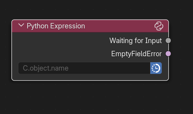

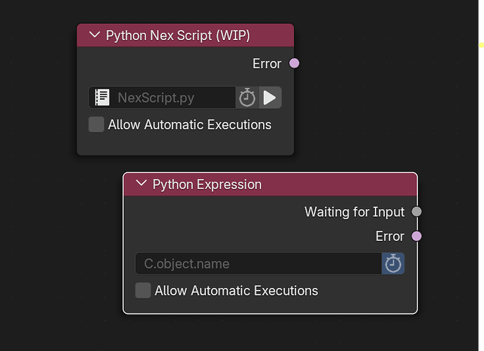

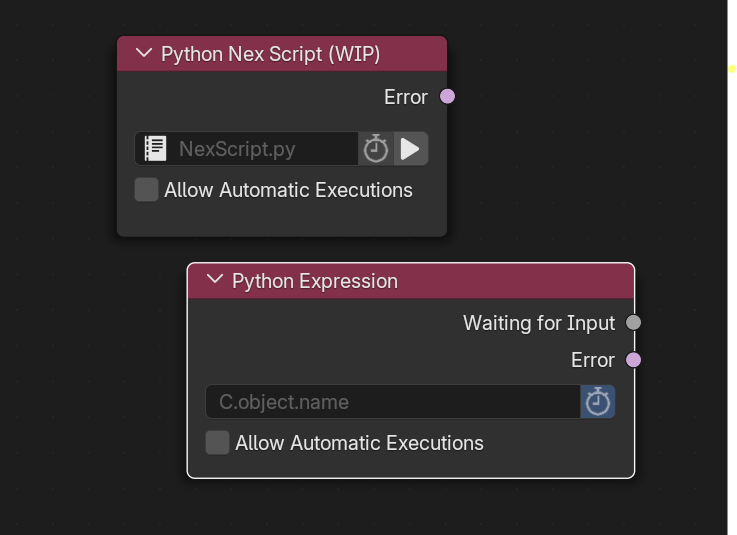

Since the expressed concerns (& demonstration :smile:) over security from the community, i’ve made some changes, i can affirm that now these custom python evaluator nodes will never evaluate python code automatically. Thanks to your feedbacks.
Users will always need to give their consent for automatic execution of python snippets on each startup by toggling the 'Allow Automatic Executions’ check boxes. (Similar to the driver warning checkbox on user startup).

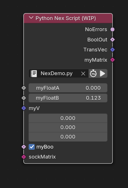

I have also good news regarding this ‘NexScript’ i’m working on.
The project is moving fast. Users are now able to do Matrix and Vector math between SocketMatrix, SocketVector and mathutils.Matrix mathutils.Vector and vice-versa.
This is the kind of node-generating langage that is currently possible
#NexDemo.py
import bpy
# Initialization
# first we need to define our socket variables!
myFloatA:infloat
myFloatB:infloat = 0.123 #you can also assign a default value!
myV:invec
myBoo:inbool = True
sockMatrix:inmat
# do math between types  using '+' '-' '*' '/' '%' '**' '//' symbols,
# or functions. (see the full list in 'NodeBooster > Glossary' panel)
c = (myFloatA + myFloatB)/2
c = nroot(sin(c),cos(123)) // myFloatB
# Do comparisons between types using '>' '<' '!=' '==' '<=' '>='
# result will be a socket bool
isequal = myFloatA == myFloatB
islarger = myV > myBoo
# Do bitwise operation with symbols '&', or '|' on socket bool
bothtrue = isequal & islarger
# You can evaluate any python types you wish to, and do operations between socket and python types
frame = bpy.context.scene.frame_current
ActiveLov = bpy.context.object.location
c += abs(frame)
# easily access Vector or Matrix componements.
c += (myV.x ** myV.length) + sockMatrix.translation.z
newvec = combine_xyz(c, frame, ActiveLov.x)
# Do Advanced Matrix and Vector operation
ActiveMat = bpy.context.object.matrix_world
pytuple = (1,2,3)
TransVec = (sockMatrix.inverted() @ ActiveMat) @ newvec.normalized()
TransVec = sockMatrix @ cross(pytuple,TransVec,)
TransVec = sqrt(TransVec) #math operations can also work entry-wise on vectors.
minElement = min(separate_matrix(sockMatrix)) #get lowest socketfloat element of Matrix.
# types can be itterable
newvalues = []
for i,component in enumerate(TransVec):
    newval = component + minElement + i
    newvalues.append(newval)
TransVec[:] = newvalues
# Because we are using python you can create functions you can reuse too
def entrywise_sinus_on_matrix_elements(SockMatrix):
    new = []
    for f in separate_matrix(SockMatrix):
        new.append(sin(f))
    return combine_matrix(new)
newMat = entrywise_sinus_on_matrix_elements(sockMatrix)
# Then we assign the socket to an output
# you can define a strict output type
# or auutomatically define the output scoket with 'outauto'
BoolOut:outbool = bothtrue
TransVec:outvec = TransVec
myMatrix:outauto = newMat
Behind the scene, the script will automatically generate the equivalent nodes of the python operand and functions. If the user choose to, he can also automatically sync the evaluated python value from the script with the nodetree with no noticeable slowdowns!
Still have a lot of work to do with NexScript, SocketInt, SocketColor, SocketQuaternionRotation still have to be implemented, but it’s getting there :slight_smile:
