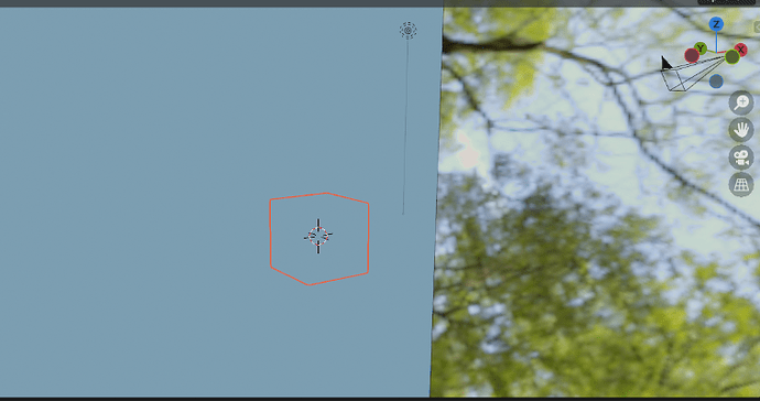

Hello everyone, please ask. During the process of debugging the blender4.0.0 code, I found that the created GPU_TEXTURE_CUBE did not specify data, but was used in the shader program. Not sure which process Iām missing.
First Cube:
Second Cube:

Yes.
I am slowly debugging the blender code and printing a lot of logs.
However, debugging on Android is not as convenient as debugging on the desktop platform.
I have also tried to use renderdoc to troubleshoot, but I am not familiar with renderdoc at the moment, so I can only simply look at the output of each frame.

The texture is used as an attachment to a frame buffer, so it is expected that data is not provided when the texture is created.
Also please note that the code has changed quite a bit in 4.2 with the Eevee-Next project landed.
