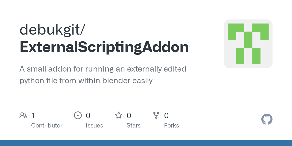

But as I’ve started to argue on external editing. Here’s a code snippet:
import bpy
import os
filename = "my_script.py"
filepath = os.path.join(os.path.dirname(bpy.data.filepath), filename)
global_namespace = {"__file__": filepath, "__name__": "__main__"}
with open(filepath, 'rb') as file:
exec(compile(file.read(), filepath, 'exec'), global_namespace)
I made it a small addon that adds a menu entry to the File menu to run a file “defaultscript.py” that is placed next to the blendfile directly: (Take a look at the readme)
Edit the “defaultscript.py” with an external editor of your choice just like you did with the internal one
