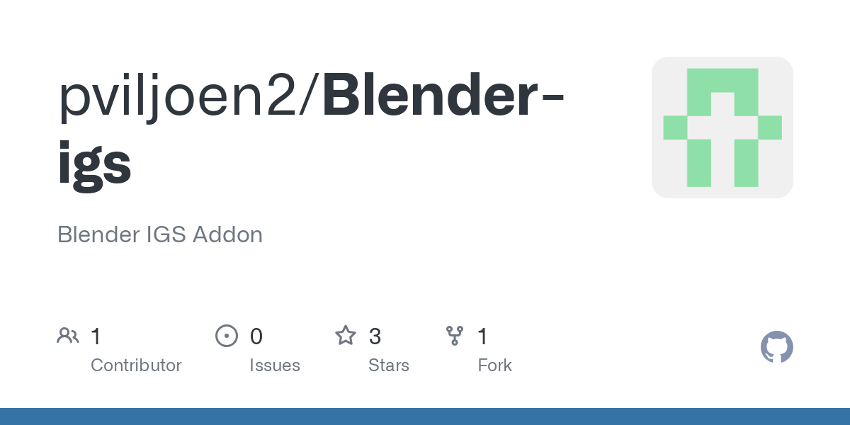

I have added files to github
Interesting. I’ll take a look at this.

Lots of obfuscation and evilness. Note also that this thread would appear to have a typo in the title (SGI should be IGS). Hunting around, it looks like a maintained addon is at :
