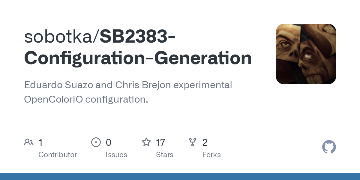

This might be of assistance:
It helps somewhat! I see that it involves an operation on the primary colours, so I suppose it could mean that the triangle they define is scaled towards the white point?
In any case, I wonder whether it’s relevant to have that detail in the English tooltip in the first place. I could well just be ignorant, but I don’t feel that most artists know about it, except maybe colour grading artists. Or it could be described in more detail in the documentation?
