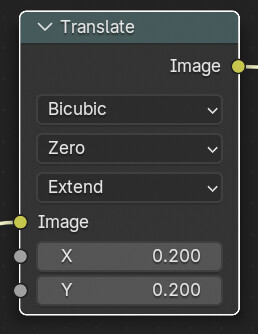

I am working on a PR for introducing the border condition in the transform node’s UI to give the user control over how out-of-image samples will affect the computed pixel. The interface for the translation node now looks like the following and is the first node to implement the boundary condition.

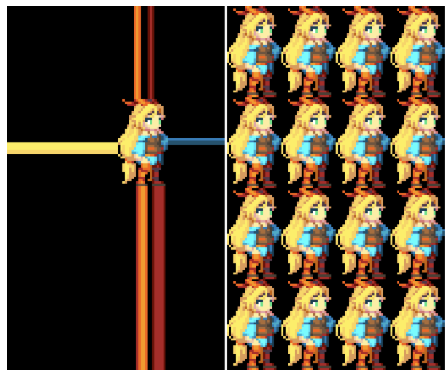

The node now implements the border condition as follows (image is courtesy of Unity, see: Unity - Manual: Texture samplers):
  • On the left-hand side is the extend case, where the pixel at the border will be repeated.
  • The right image shows the repeat case, where the image is repeated outside the border.
  • The last case is the zero case, which just pads the image with zeros.
We allow the configuration of the boundary condition for both axes.
