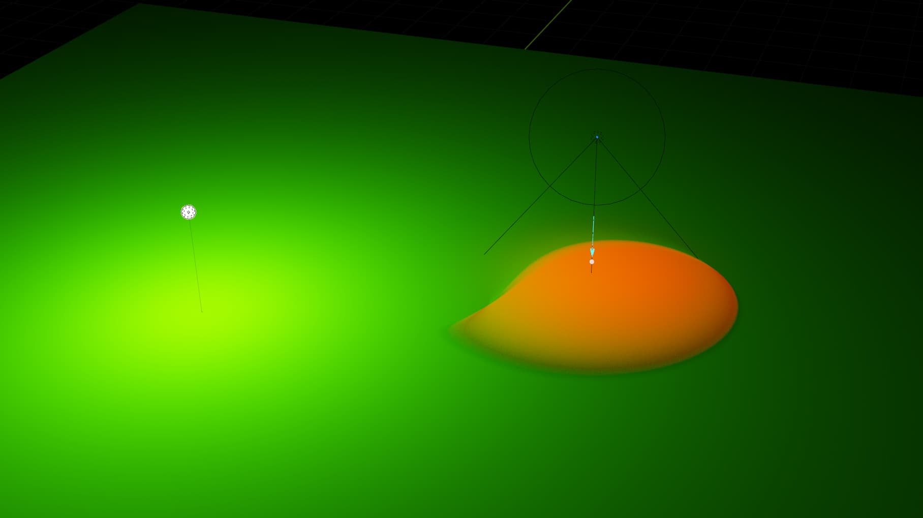

I’m going to report some more limitations (and bugs?) I found in Many Lights Sampling.
I’m sorry @Jebbly. I know getting bug reports is good. But getting a list of multiple bug reports can be disheartening, which is why I’m sorry.
Spot Light Large Radius Importance Issue
When a spot light has a large radius, it gets given too much importance in some areas where it shouldn’t (the edges of the spot light).
Here is the .blend file:
Renders
Here is a render with three lights at 128 samples.
Many Lights Sampling Off:
Many Lights Sampling On:
Mesh Face Count Importance Issue
As the face count of a mesh light increases, the object ends up with an overal increase in importance (which it shouldn’t have).
Renders
Here are two renders of the same scene rendered at 16 samples per pixel with Many Lights Sampling On. The only difference between the two is the level of sub-division surface modifier on the cube (light emitting mesh)
Low face count (16spp - Many Lights Sampling On):
High face count (16spp - Many Lights Sampling On):
Lights With Textures Importance Issue
Lights with textures that drive their look and some complex node setups result in the light having the wrong importance in certain areas. I can understand how fixing this could be a complex task and could be outside the scope of this GSOC.
Renders
Here are two renders at 128 samples. There is a spot light in the middle with a texture driving it’s output.
Area Lights Spread Importance Issue
The “Spread” parameter on area lights doesn’t appear to be taken into consideration when calculating the importance of a area light.
Here is a .blend file:
Renders
Here is a render at 16spp show casing the differences between Many Lights Sampling On vs Off. The spread on this area light is “1 degree” so it should only cast light directly in-front of it. However Many Lights Sampling appears to treat the area light as if it it a much larger “spread”.
Two Different Brightness Lights Noise Issue
When two lights of very different brightnesses light up a overlaping area on a surface, the result is an increase in noise with Many Lights Sampling On. Maybe the bright light is given too much importance?
Renders
Ray Visibility Issue
With Many Lights Sampling On, lights will still be considered as “emitting light” and “important” even when they are not visible to that specific shader. For example, if I make it so a light is not visible to diffuse surfaces, when Cycles samples that diffuse surface, Many Lights Sampling acts as if the light IS visible to the diffuse surface and thus priorities rays towards it even though it shouldn’t.
Renders
Here are two renders at 16spp show casing the issue.
Mesh lights behave differently compared to the point light from above and some times do work as expected. This is why I only disabled the Diffuse and Glossy ray visibility here.
No worries, thanks again for the bug reports. Some of these issues seem relatively straightforward to debug. I have a few notes for each one:
  • I have a general idea of what’s going on for the spotlight - I believe it has to do with the relationship between the bounding box and the emission profile. This one might be a little tricky to fix because it may be inherently related to the algorithm used in the paper.
  • The mesh face count importance issue confirms that triangle area should be used in the energy heuristic. I’m hopeful that this will fix the issue. (RESOLVED)
  • Textures are something that Brecht mentioned before. It will be a little tricky too, and we’ll have to figure out a heuristic for that end.
  • The area light spread is an error on my part, I don’t think I’ve taken the area light spread into account for the orientation bounds. (RESOLVED*)
  • The two different brightness issue is actually quite surprising to me, because given the intensity of the left light, I would’ve expected it to have a much larger impact myself. The heuristic being used may be weighting energy much more than it should be.
  • The ray visibility issue seems to be the trickiest issue because there may be lights with the options enabled/disabled mixed together, which could skew the importances for some cases. The most straightforward solution I can think of is to create a tree for each visibility option, but I’ll have to explore this further.
The easier-ish solutions are things that’d I’d like to resolve in the coming week, so this does mean I’ll probably have to push back plans for volumes until later (I think this is a good thing because I’d like to understand the theory better as well). The trickier issues are things that I’ll have to discuss further with Brecht and Lukas at some point.
