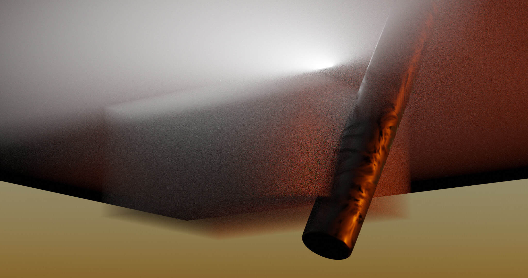

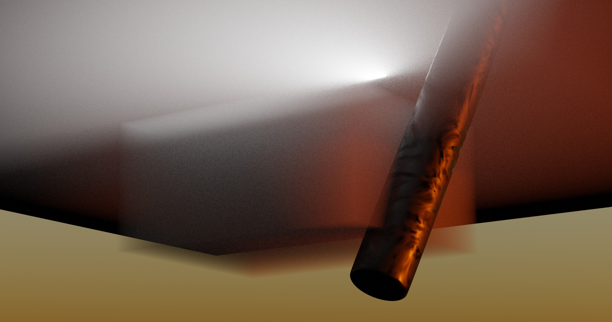

In the next test I ruled out the instancing and mesh lights. Same scene with two lights only (area light and Nishita Sky) with:
  • removed mesh light instances
  • added one mesh with diffuse shader and noise-driven roughness
In this example with MLS the mesh is slightly improved where it’s directly lit by area light but the volumes are more noisy overall. Especially in the parts lit by Nishita Sky.
Light tree disabled
rendering time: 2 min
Light tree enabled

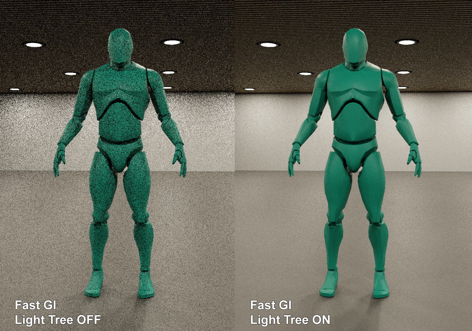

An example of the light tree at work:
Fast GI / Mesh lights
LT OFF: 175 samples
LT ON : 100 samples
Rendering time: ~13 sec

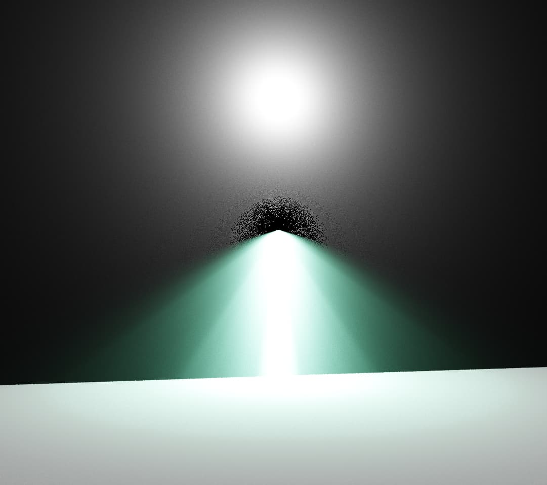

Example of a textured light
In this example I have a normal white point light on the top and a bright teal point light below with a IES texture driving it’s output. You can see there’s a weird black spot around the teal lights emission point. This is because Many Lights Sampling is directing a lot of samples towards it because the light tree has it represented as a “full point light” rather than a point light with bits “turned off” with a texture.

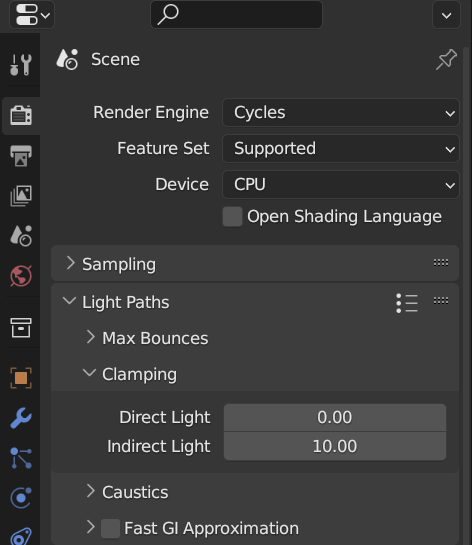

This is caused by the “clamping” setting in Cycles. It reduces the brightness of lights to avoid fireflies. But due to how it works, it ends up producing different results when you use a different light sampling strategy, and in the case of Many Lights Sampling that typically means there is an increase in brightness when using Many Lights Sampling with clamping compared to having Many Lights Sampling off with clamping.
You can find the setting for clamping here (setting it to 0 disables clamping):

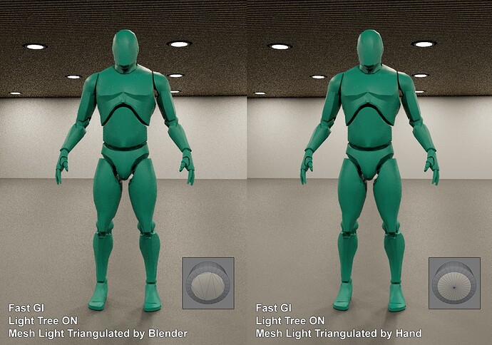

Strange. Afaik once the mesh hit’s cycles it’s always triangulated? But the triangulation of the circle will lead to a lot more very small ugly triangles in the first case, so that might explain the difference?
Hope this answers your question:

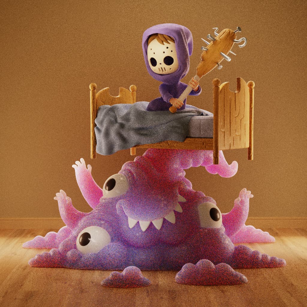

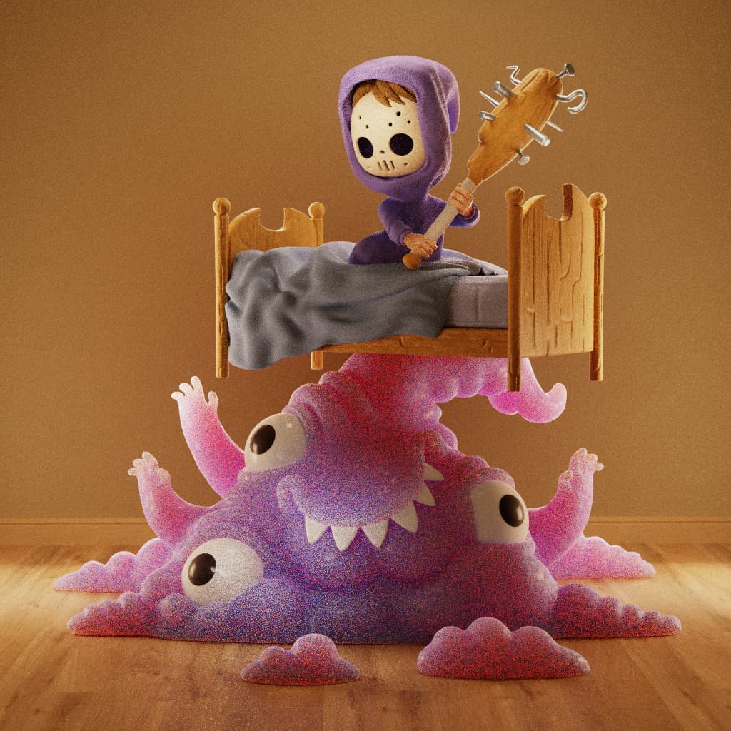

I’ve noticed kind of ‘floating’ strange behavior. When there are multiple light entitles (‘real lights’) present in the scene, enabling ‘Light Tree’ adds noise in those areas. I call it floating, because it happens only in some scenes. Here is an example from the “Monster Under The Bed” scene.
To make effect more noticeable I lowered the number of samples to 64:
Light Tree OFF:
Light Tree ON:
Look at the character on the bed, the blanket and the wall behind him.
The Light Tree is an approximation of the lights in the scene, used to help pick which light a ray should sample. Sometimes the Light Tree is too simple of an approximation and ends up increasing noise in some situations.
In this specific scene, this is exactly what’s happening. The artist is using Ray Length and Map Range nodes to create a custom fall off for some of the lights. And the Light Tree does not include this custom fall off in it’s approximation, meaning it sometimes prioritizes samples towards lights that make minimal or no contribution to that specific spot, thus increasing noise.

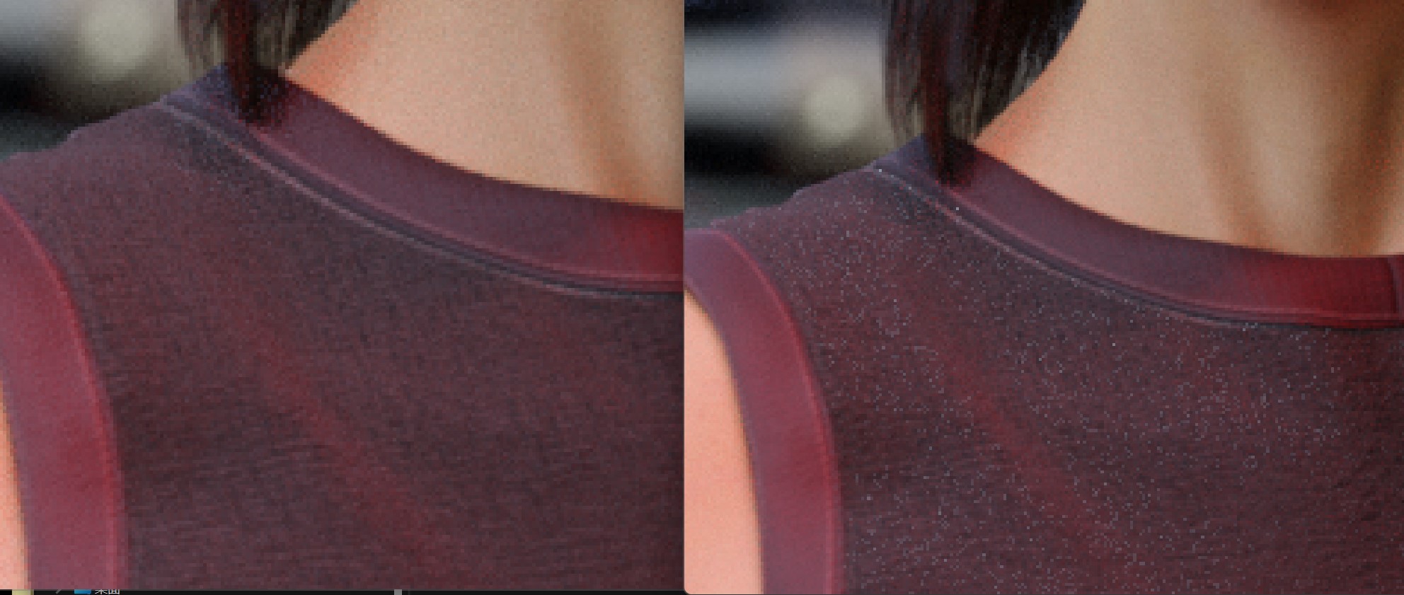

both were rendered on RTX4090 Optix only with 5000 samples and the same light paths setting denoise was off, the left is “light tree off” and took 2:42.09. The right side is “light tree on” and took 3:07.75
when the light tree is turned on, the background noise and the shirt detail are better, but the fireflies are pretty noticeable. all emission materials were set to “front”, but the fireflies are still the same.
my character is still confidential so I can only provide the project with that garment in the scene
