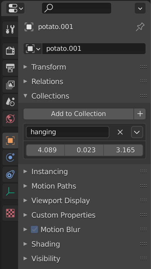

Collections already have an origin that is used to define the origin point of Collection Instances. There are several ways to change it to any value you want. It would be great if there was a way to easily see and move the origin point you have set on a Collection.
The complication is that an object can exist in infinite different collections. This is why I would prefer an official concept of “groups” where the group members cannot be a member of more than one group AND a concept of “group instances” to go along with it.
