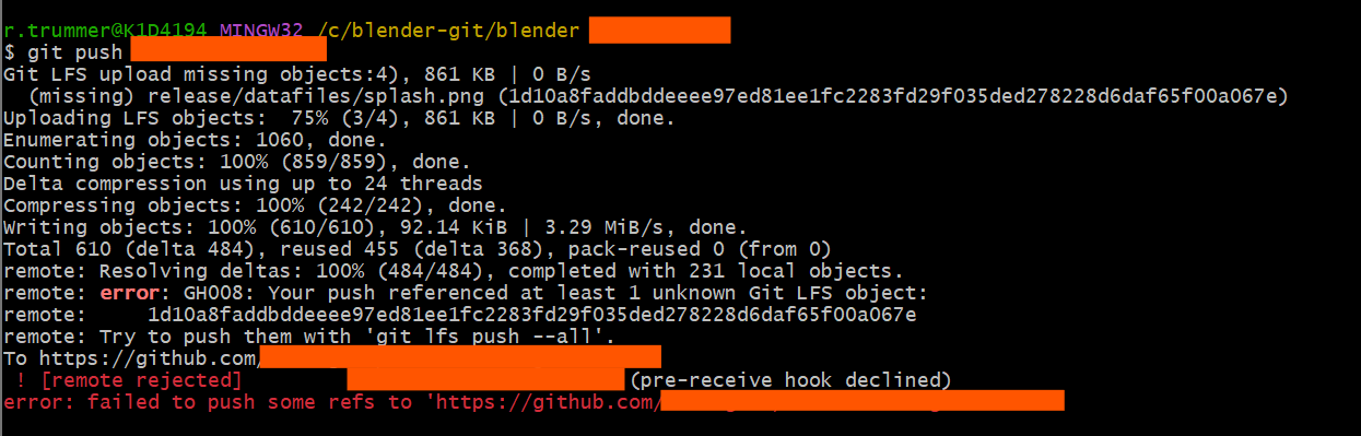

trying to push my custom branch (the LFS source file is definitely on my local file system):

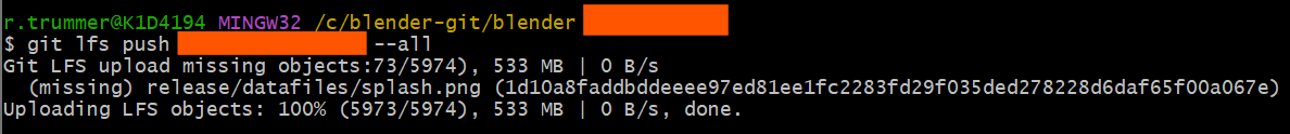

trying to push all LFS content to my remote:

Try git lfs fetch --all before pushing.
By default LFS will only fetch files it actually needs. The splash was recently changed in the 4.5 and 5.0 branches, which means there are currently 3 splashes stored in LFS. You probably do not have one of them locally.

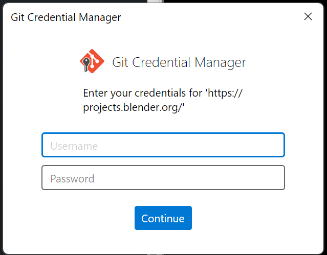

When I try that, I get stuck at the credentials manager. Why would I need to login, and which login is it? I just want to pull, not push.
credentials
never mind, after finding my login details and resetting the password, I was able to run the fetch command and push the changes to the other server. Thanks for your help!
