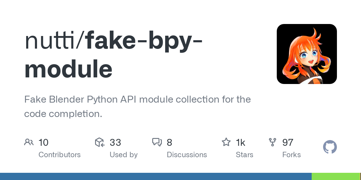

There is also

The nutti/fake-bpy-module solution works great!
I just had to:
  1. Download the zip: Releases · nutti/fake-bpy-module · GitHub
  2. Extract it somewhere.
  3. Add the extracted folder’s path (ie. of the inner fake_bpy_modules_XXX) to your IDE’s list of Python-autocomplete sources. In VSCode, this means adding the following to your workspace’s settings.json file:
    "python.autoComplete.extraPaths": [
        "<path-to-extracted-modules-folder>"
