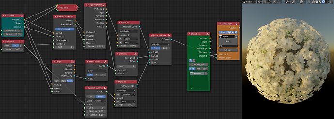

I thought it could be useful to show how scattering flowers workflow can look in Sverchok.

I like Sverchok to an extent, but honestly this looks too bogged down to me. I feel like all you need to achieve that should be no more than 5-7 nodes. Starting geometry, Point Distribute, Attribute manipulation, Instance to points, and maybe a mask thing in there, but you can do that with attribute manipulation I feel.
I much prefer the attribute workflow that seems to being worked on here in blenders geometry nodes. I know with this setup in Sverchok you have a lot of control but it just seems there is too many nodes flying around. I think it’s easier when you can follow a ā€œcourse of eventsā€ that makes itself more obvious to the artist. For instance, in this sverchok image, I’m not even sure what that ā€œMeVā€ node is doing up in the left corner there.

The flower scattering workflow can be done a little bit more straight forward with SV as well if you’re prepared to borrow normals from the base mesh. Obviously I’m not doing anything avoid collisions though.

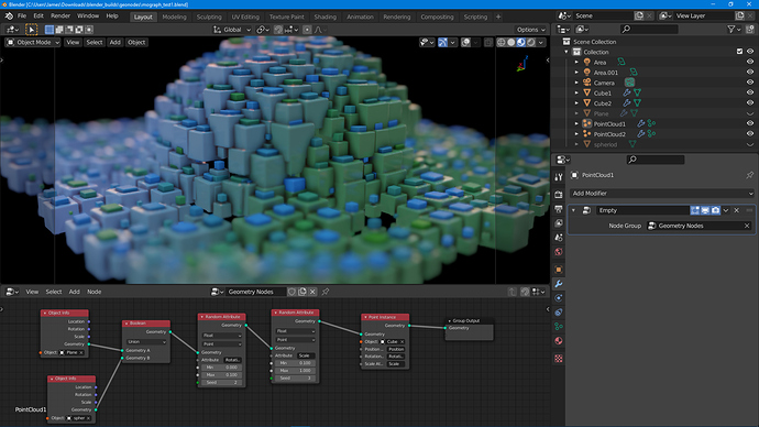

A simple little mography thing using the current build and eevee. Blender is going to be killer for mograph in the next year or 2 with the combo of geonodes and eevee. My background is using the typical C4D/AE combo for mograph/broadcast, but I can really see Blender taking much of that market share within a coupe of years. Add in some of the upcoming blender tech like viewport compositing, vulkan realtime raytracing and greasepencil/lanpr and there are interesting times ahead…please excuse my enthusiasm :slight_smile:
Really looking forward to some sort of falloff system and procedural noises in geonodes that can be used to drive attributes. As well as a time/frame node to drive animation.

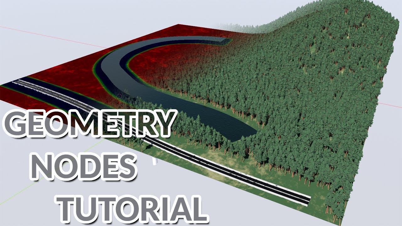

Hi, here’s a tutorial for my previous forest video, enjoy.
