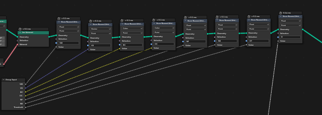

The biggest problem I work with NPR or game effects in Blender, is that we don’t have material reusibility Sign in - Blender ID - blender.org
Often I have to Hack using Geometry Nodes.
and these still don’t solve problem such as “Color Ramp”, “RGB Curves”, etc.
