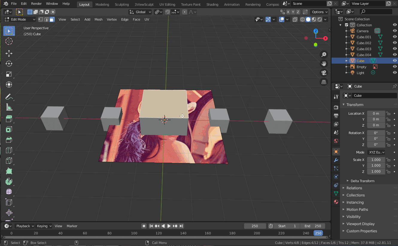

Here is an example, why it’s more flexible. You can align the camera to an arbitrary rotation of your choice. In my case 45 degree on all three axes. You just have to set the image to that angle and it would work.
But when I say its more flexible. It does not mean that its really that useful to be able to do that. At least for me. Some may disagree.
demo
