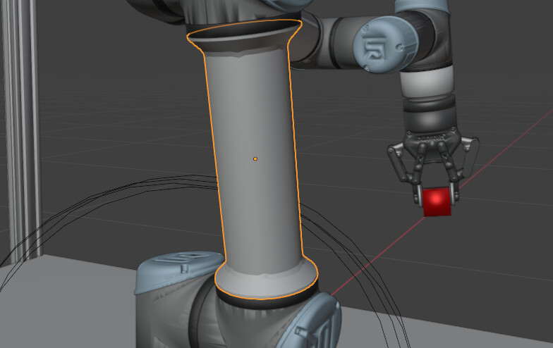

This is without the modifier:

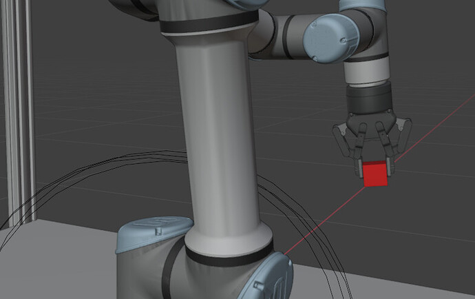

This is manually add the modifier:

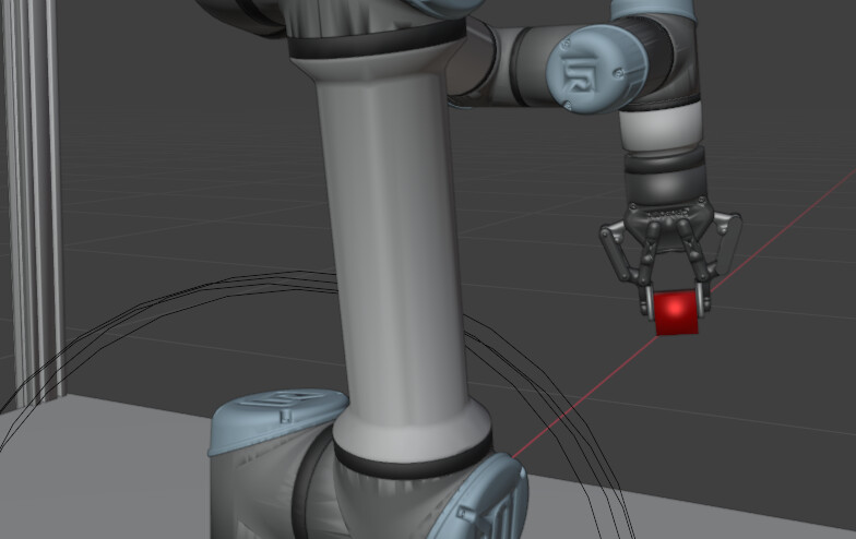

This is with code to add modifier:
