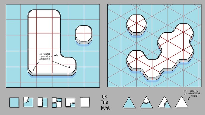

I am making some equilateral triangle/hex grid tiles in this style:
In order to help with creating the girds, I had to make creative use of vertex snapping to assemble tessellated hexagon mesh, and write a script to bisect the faces to create an additional equilateral triangle grid.
This works well enough for the moment, but I would really like to make a plugin which replaces the normal 3D viewport grid with a dual hexagon/triangle grid, with snapping support.
