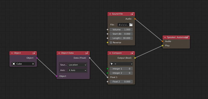

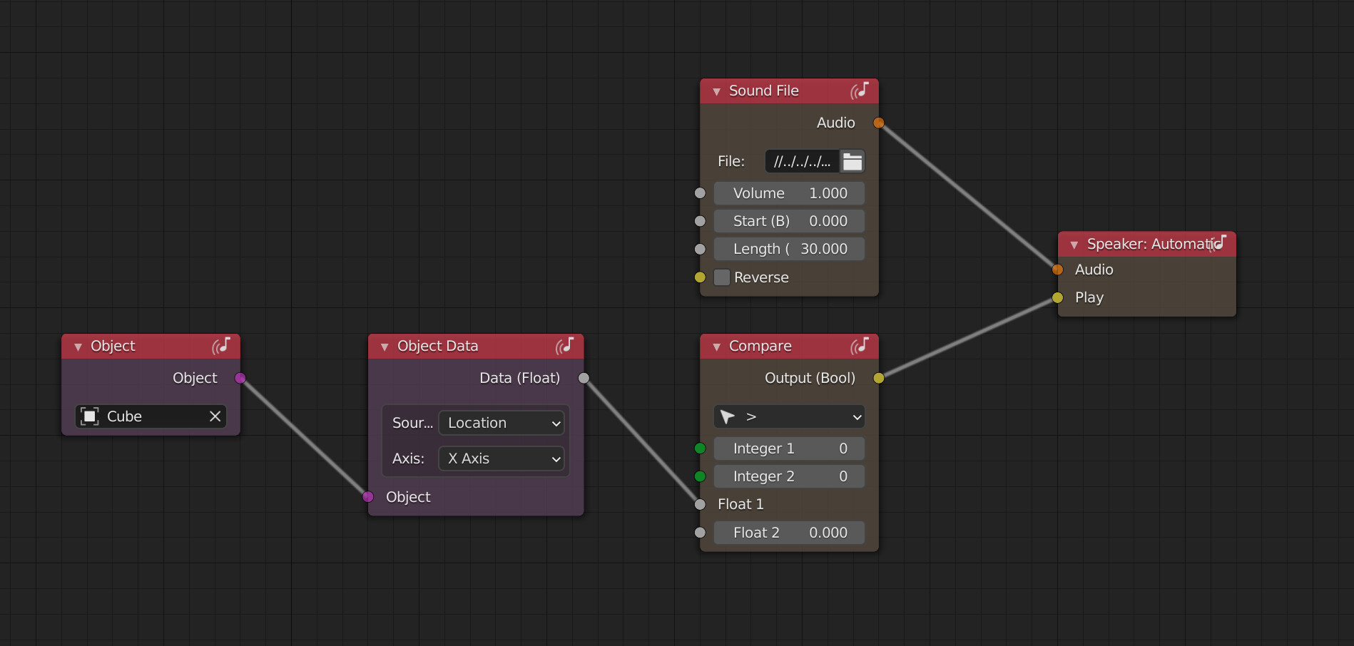

You can see here that the Auto Speaker node has a Boolean input, so if you send a message to this using other nodes you can trigger when it plays, You also need to have the Execution mode set to either Frame Change, or Timed so the system executes…
Hope this helps in the meantime until I get myself organised with this once more…
So, here is the new Object Data node that will send the location, rotation or scale transform of an object. Here I am sending it to a Compare node to produce a Boolean:
In this case if the X location is greater than 0, the sound file will be played.
Cheers, Clock.

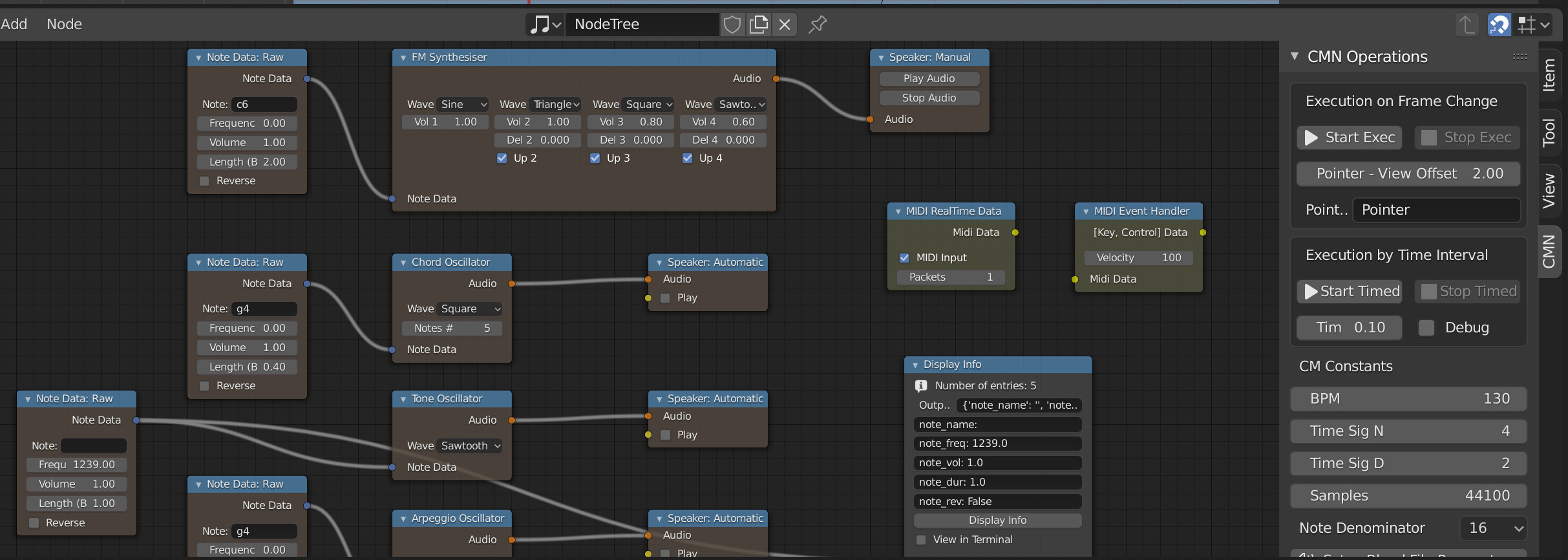

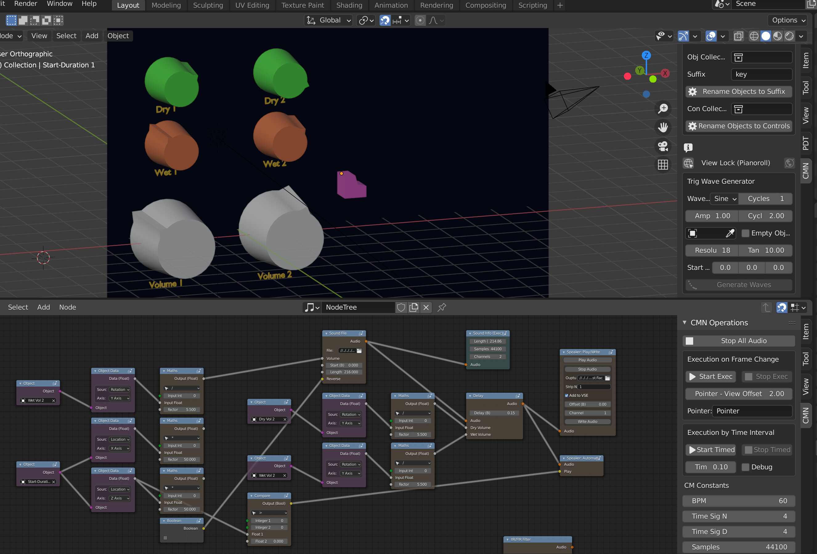

I have found some time to get back to this and have made a number of changes, a picture:
This shows a primitive start to a Mixer Desk. I have adapted the Object input and Object Data nodes so they can now send location, rotation and scale values on the three Global axes to other nodes. This I have used to set the volume of the file being played.
After much frustration I have finally worked out how to properly read the values from either the socket itself, or a connected node. Believe it or not you must check these in the right order, i.e. connected node then it’s own value, or it gives what appear to be random numbers…
I also modified some of the filters so they have a Dry and Wet volume input, this allows the user to mix Wet and Dry output, or simply bypass the filter by setting Wet output to 0.
The curious little pink object is being used to determine the start and duration of the sound file being played - X location sets the start, Z location sets the duration. If Z location is not greater than 0 the output speaker is disabled btw.
Thee changes have been uploaded to GitHub, but I still have not made a release, so install it as per the Readme on the GitHub opening page.
Still a long way to go with this in terms of finishing the function Todo list (including a Granuliser), cleaning the code and adding all the DocStrings, etc. Testing on 2.93 is going well, but I will wait for official release before completing this job. Thanks must go to my friend in Italy for keeping me going with this and providing much needed technical input on the DAW side.
Cheers, Clock. :grin:

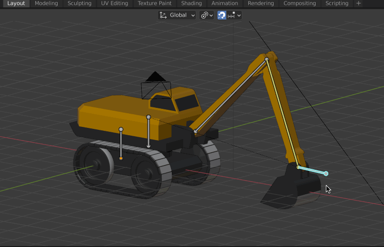

Well, I have managed to record a little GIF:
test
Which shows my mini digger operating. Not too impressive really, until you realise that it was controlled in real time by my Korg nanoKontrol2…
Two buttons move it back and forth and rotate the body and three sliders control the position of and rotation of the bucket.
Here’s the NodeTree:
I might get around to explaining how to do this on the Wiki soon… :joy:
Cheers, Clock. :upside_down_face:

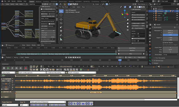

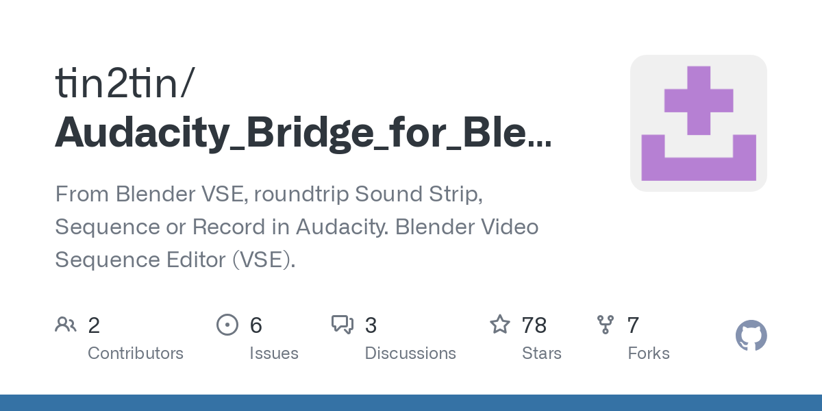

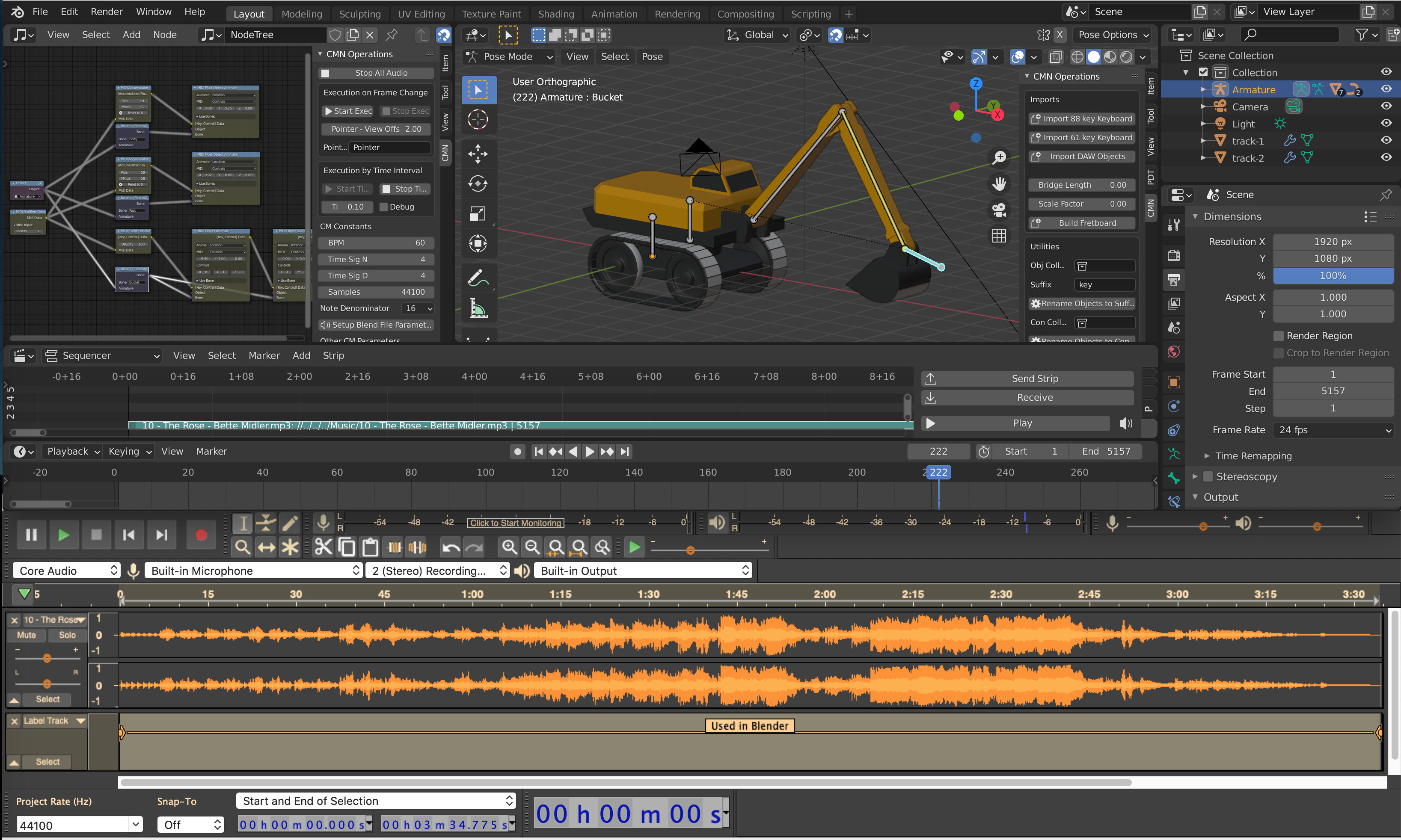

Something else to show you, thanks to @tintwotin for this piece of magic:
Blender and Audacity happily working together on my Mac.
Cheers, Clock.

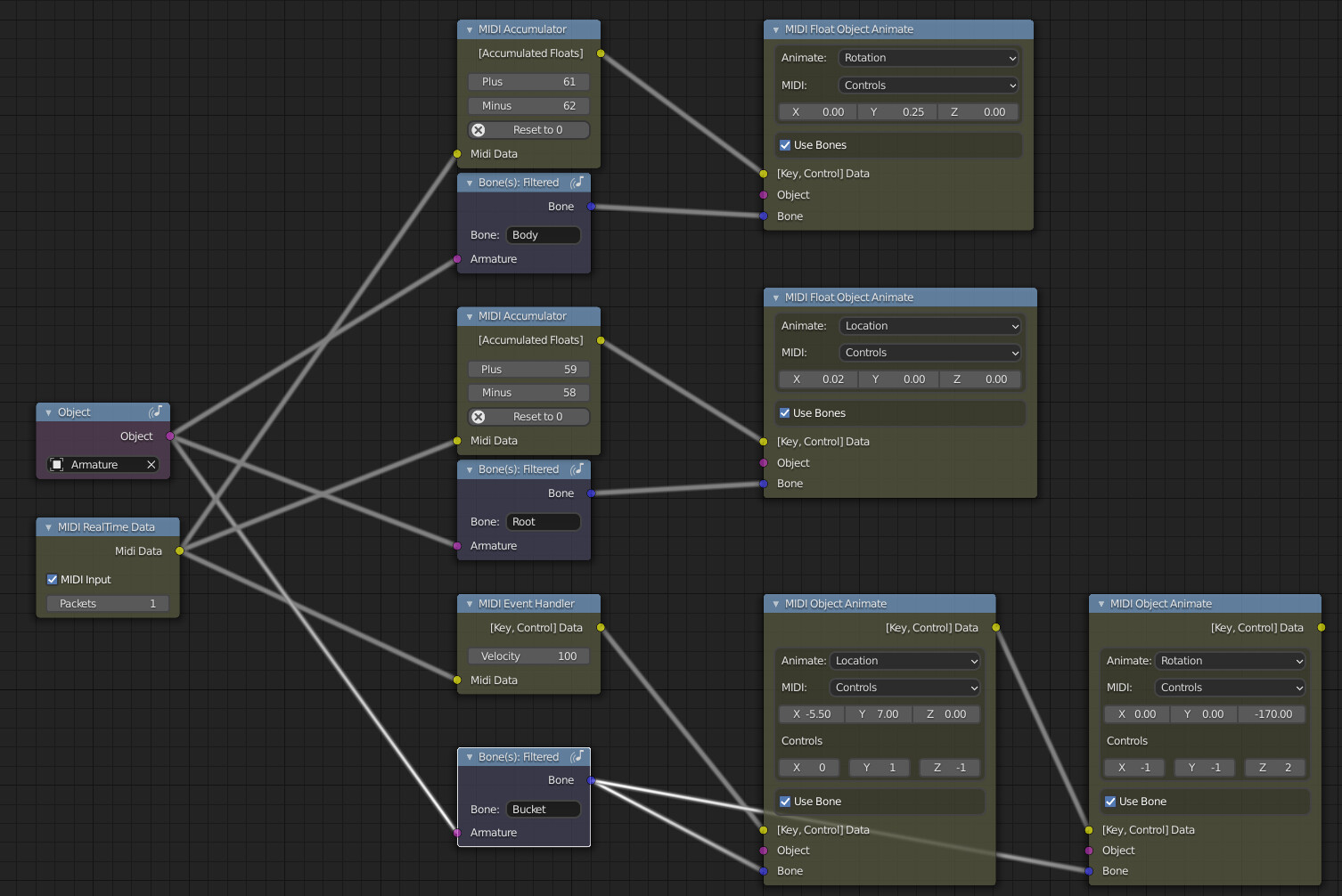

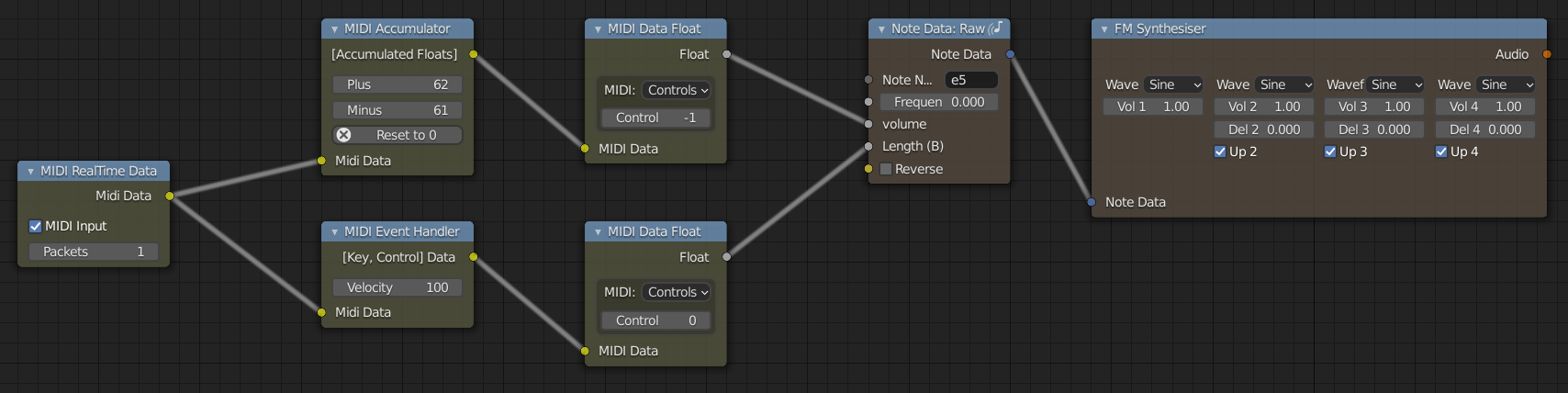

PS. Just wrote this node to take the Float value only from a Live! MIDI feed so you can set any Float Input Socket in the NodeTree with a MIDI Controller, or Keyboard:
The lower one uses a Slider, the upper one uses two buttons on my Korg nanoKontrol2.

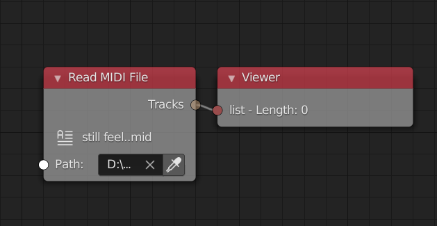

I did read the animation node midi documentation and followed the steps to explore the tracks, however animation node seems to think that the tracks are empty (list - length:0).
I tried to replicate the issue with another midi file but couldn’t.
Since my midi file can be read in other software, my guess is that the data structure of the file may be non-standard, however after converting it to CSV (with midicsv-1.1) I didn’t notice anything weird in it, so I’m not sure what the issue is here.

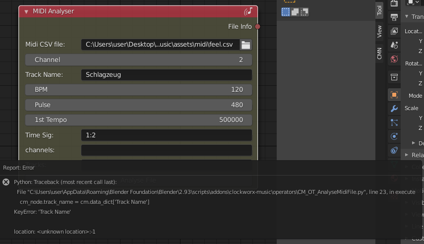

Here’s a screenshot of the issue (in blender 2.93.2):

I followed your advice, animation nodes do not throw an error in the console but the clockworx music addon does :
Python: Traceback (most recent call last):
  File "C:\Users\user\AppData\Roaming\Blender Foundation\Blender\2.93\scripts\addons\clockworx-music\operators\CM_OT_AnalyseMidiFile.py", line 23, in execute
    cm_node.track_name = cm.data_dict['Track Name']
KeyError: 'Track Name'
location: <unknown location>:-1
OK, I’ll. take a look later today.

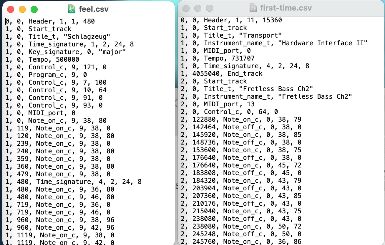

I am guessing there is a non-standard track in there, so it’s not analysing the file. It seem to have picked up the BPM, Pulse, Time Sig & Tempo tho…
OK, your file does not conform to MIDI standard!
Yours is on the left, a good one is on the right. Your should look at the number on the left, the file descriptor information is always in Track 1 and should contain the MIDI tempo, time sig, etc. Then the individual tracks should be in Track 2 onwards. You file has all the music info in Track 1. So if you look at mine, Track 1 has an “End Track” time offset of 4055040, then Track 2 starts, these are the instrument tracks after this, each one of which should have an “End Track” time offset.
Note-on and Note-off entries should never be in Track 1 as this is not for the music itself. This is why neither the AN, or Clockworx Music addons can read the file, I will add a trap for that in the code at some point soon and add an error message that tells you the file is corrupt. Also yours has a very low Pulse value, this is the last entry in the first Header line, this will not give you very accurate time info.
In my file you will find several tracks numbered 2 onwards, for the separate instruments, I can’t upload it to this site, but if you send me a private message with your email (don’t put your email address on here) I can send you this file.

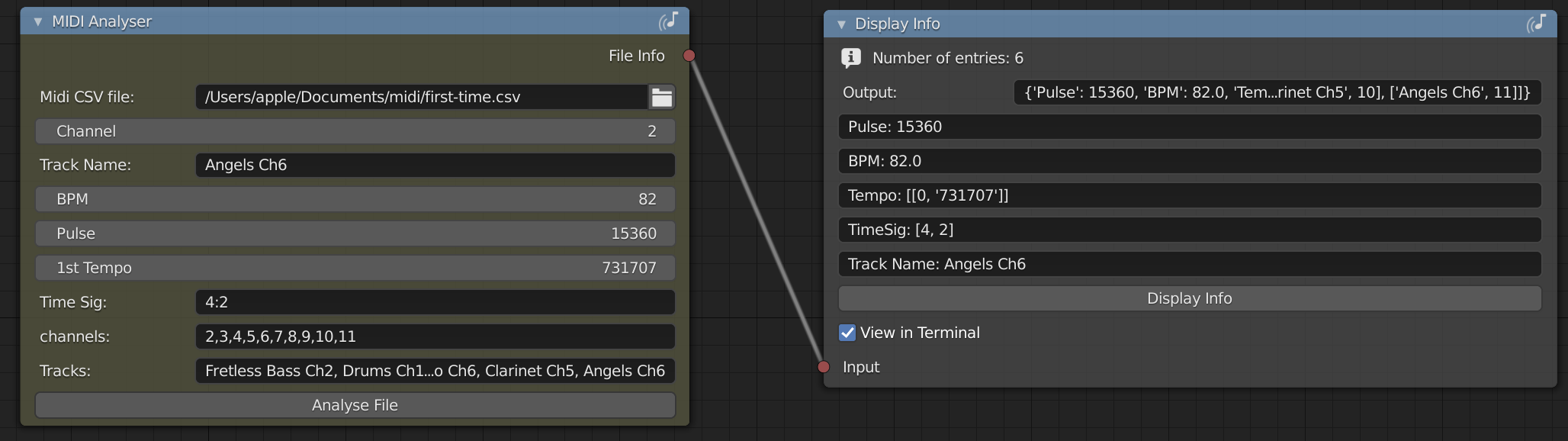

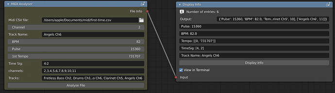

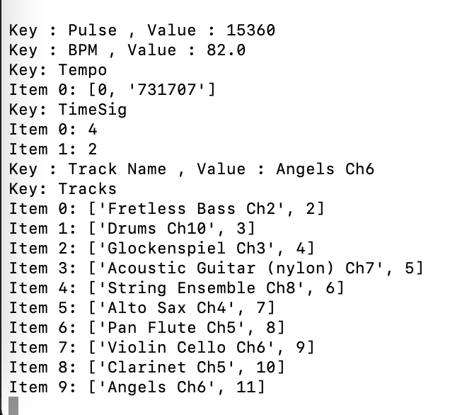

Here is an example of what the node should look like:
And a screenshot from the terminal, note I have checked “View in Terminal” on the Info Node.
Cheers, Clock.
EDIT, the same problem exists in sample.csv file…
It’s worth noting that if every instrument was in the same Track, like Track 1, the programme would have no way of splitting individual instruments from the MIDI file.
