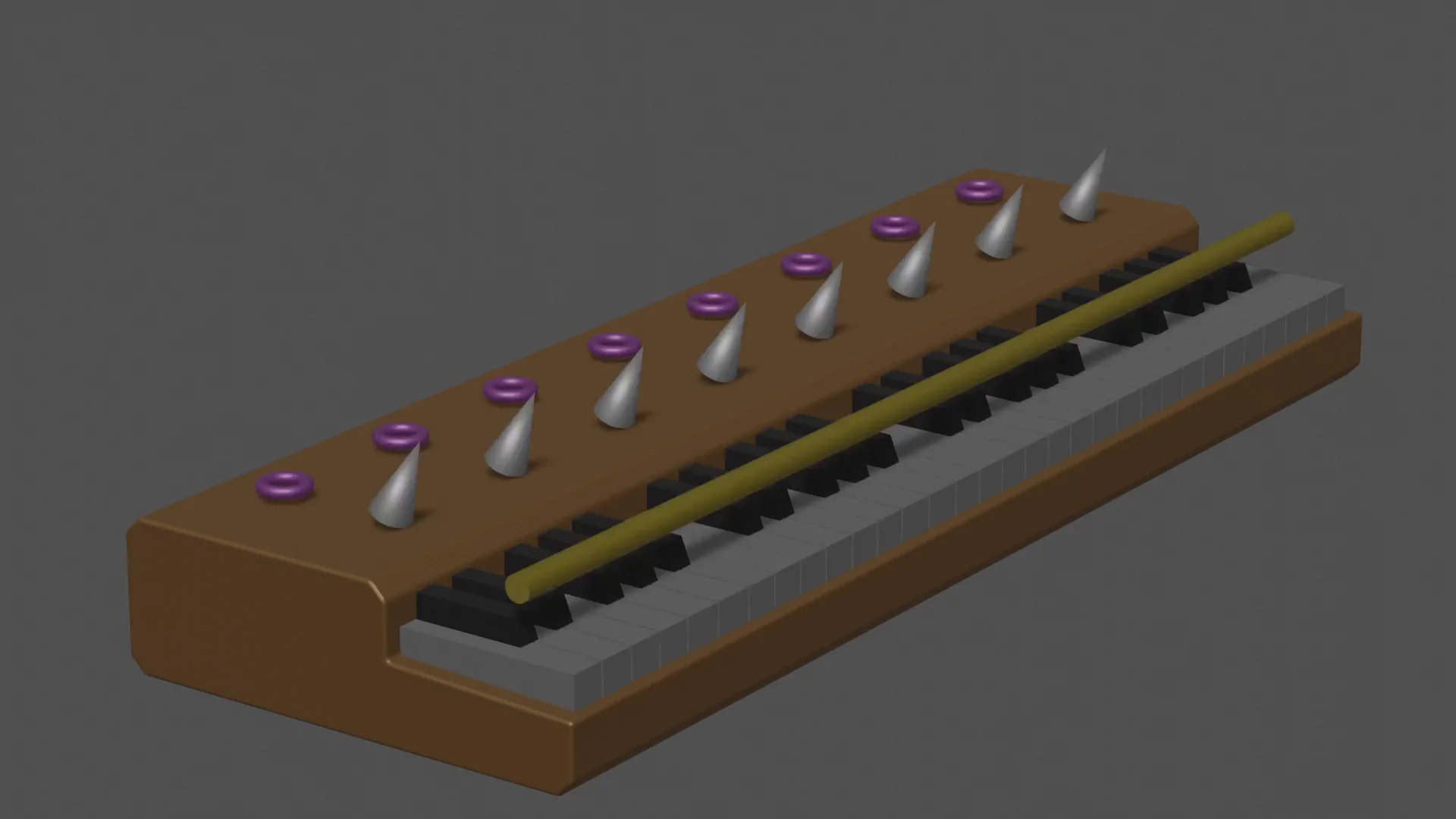

Yay! First Time Ever I Used These Nodes:
All done with CMN from the MIDI file; sound, animation & render. :notes: :film_strip: :film_projector: :thinking:
A bit primitive, but one must start somewhere…
Cheers, Clock :tumbler_glass: :dancer:

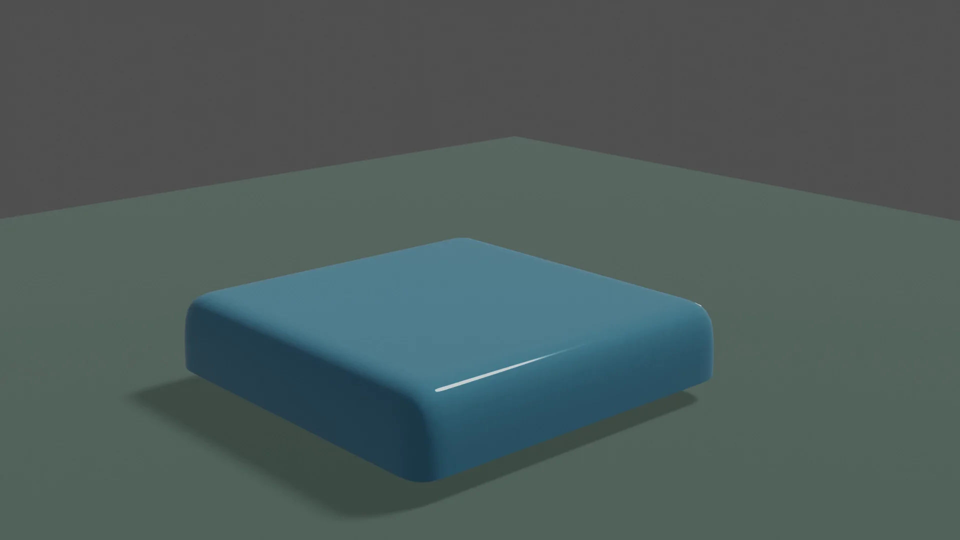

Next item on the ToDo was to animate Shapekeys using MIDI Controls:
So, here I have used the drum track from “First Time…” to animate this mesh, it has a shapekey for each drum note. I have also revised the Collection and Object nodes so they use PointerProperties (“it’s about frickin’ time you worked that one out Clock”), but maintained the “Object(s): Filtered” node so you can still make a list of objects using a search string, same goes for my “Collection(s): Filtered” node. The index of -1 means all objects BTW, not the last one…
Cheers, Clock. :stuffed_flatbread:

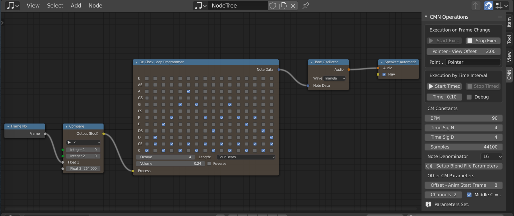

These new nodes allow me to animate Materials and Colours ,etc. I have also made a Compare node that could be used to change something after a certain frame number for example:
100% • 75% • 50%
Cheers, Clock.

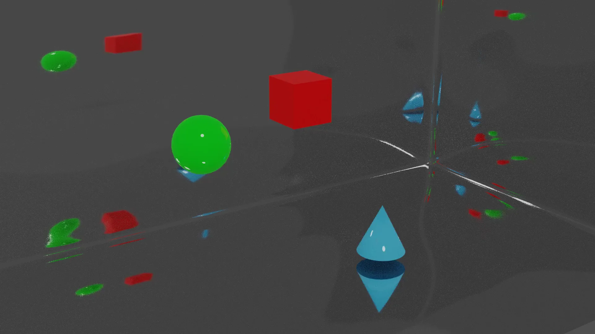

Latest Video:
This one uses the new Bounce node (borrowed from my older AN nodes) to bounce the first two objects and the Frame Ramp node to rotate the cone, here is the node tree:
I have also added a Compare, Condition & Maths nodes to the suite to enable more intricate modification of input signals. I hope to have these new nodes uploaded shortly after some more testing. Some of the new nodes were borrowed from my older AN additions, adapted to the new system. The new system also includes nodes to modify materials’ colours, etc.

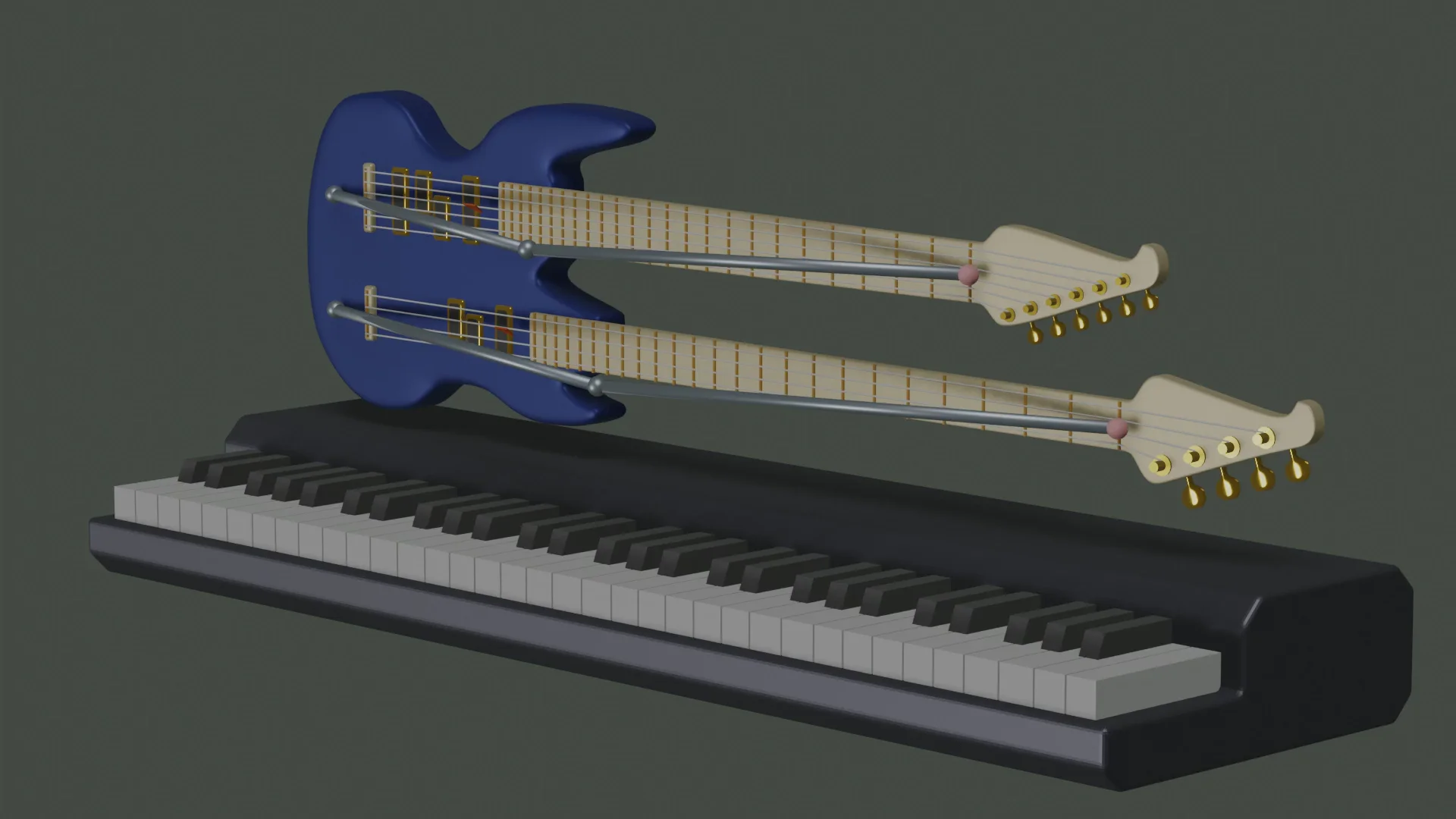

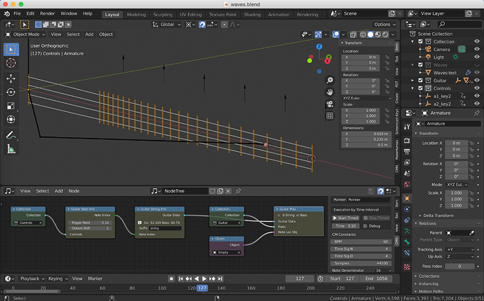

Next, Animated guitar from CMN:
Uses the MIDI file to get the song, then translates the notes into fret and string positions, placing the little pink sphere at the right location, the armature is for an animated arm at some stage.
Cheers, Clock. :guitar: :bomb: :upside_down_face:

Here is the video I was rambling about in a previous thread concerning the Guitar Nodes:
And the node tree:
CMN won’t do chords on a guitar yet, I m looking at ways to do this as we speak…
Cheers, Clock. :guitar: :superhero:

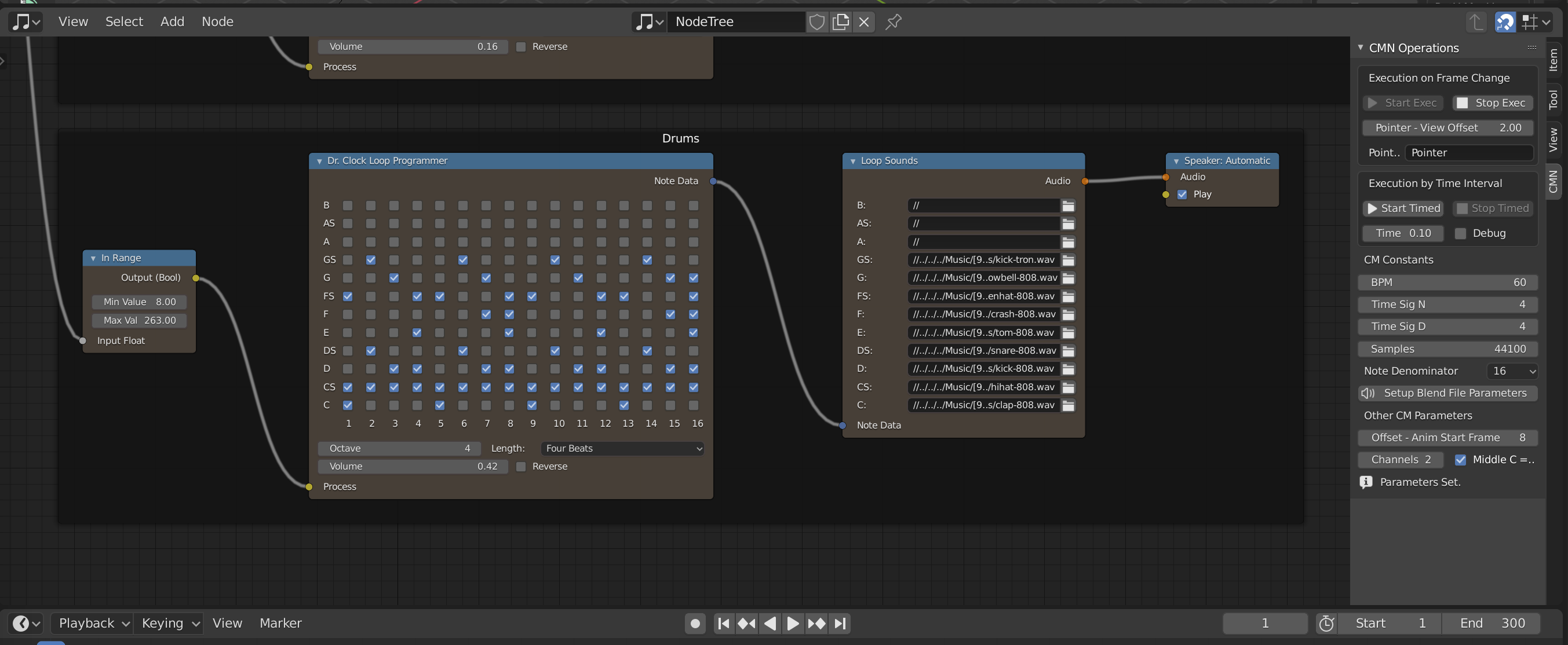

Update, now we have a Loop Programmer - “Dr. Clock” (reference Dr. Rex in Reason):
Still a way to go with this before I upload this change…
Cheers, Clock. :dash:
EDIT:

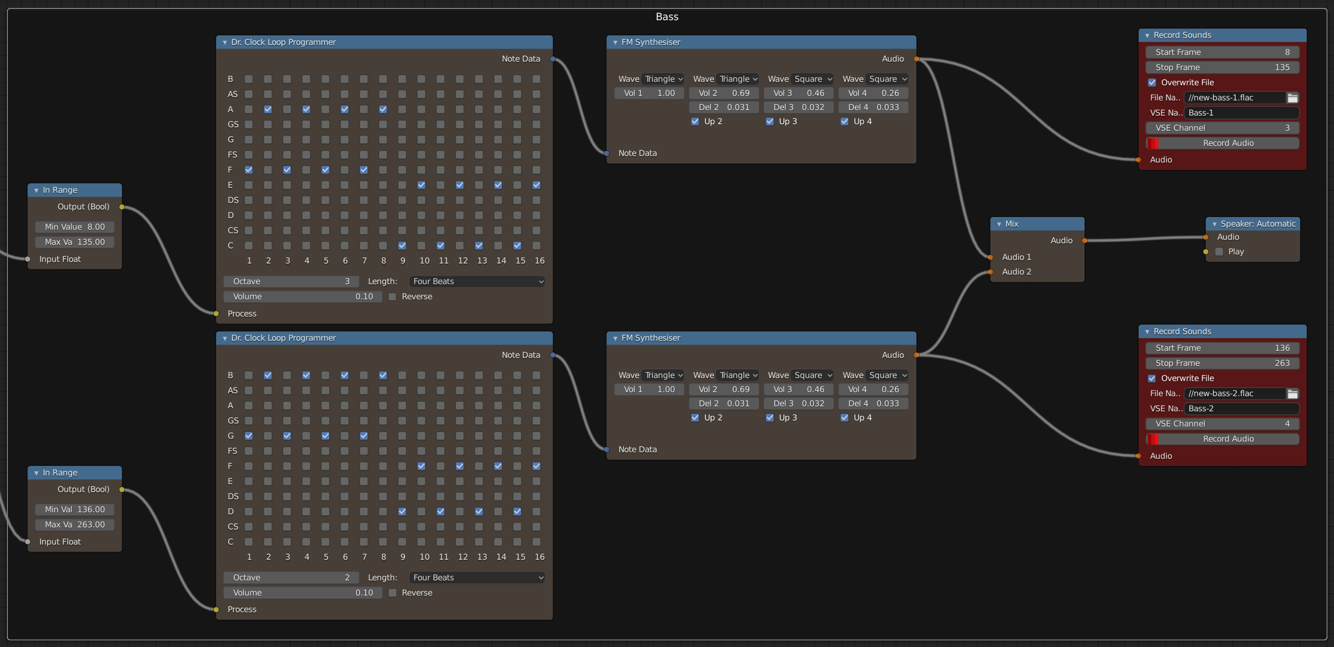

Drum Machine, or Programmer for Sound Samples if you prefer, either is apt:

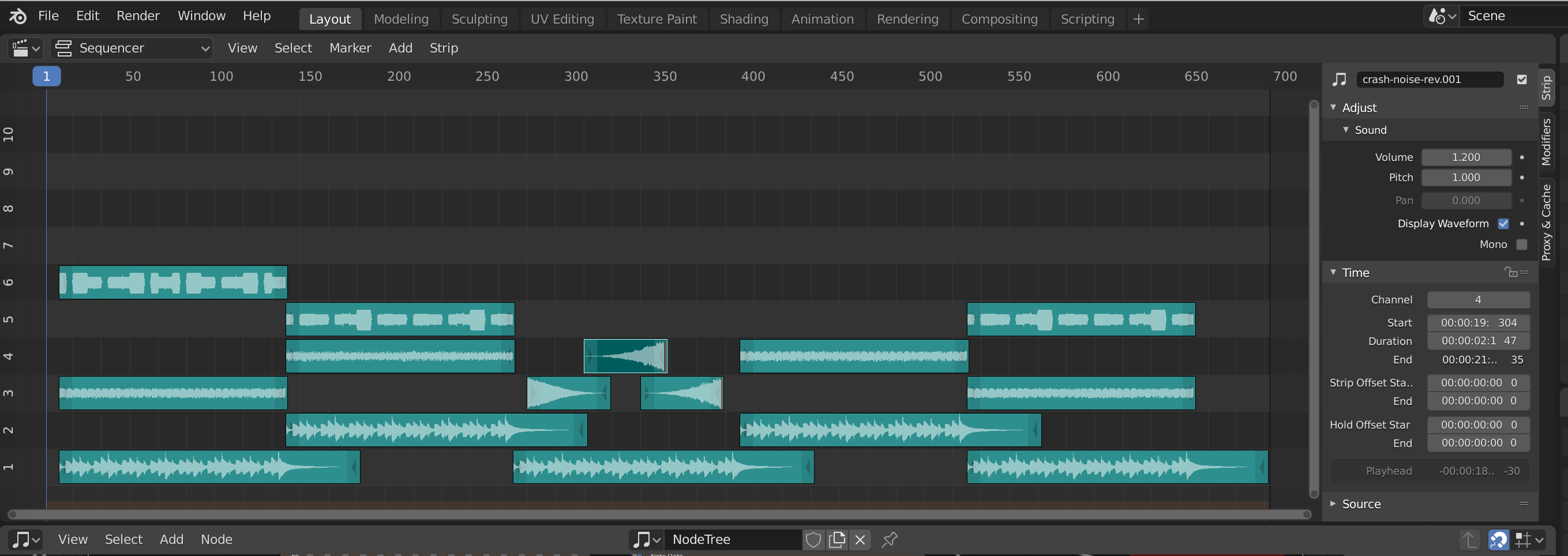

Now I have a Recorder to record the Loop so the can be added and duplicated, etc. in VSE to make a complex song structure:
Here are the VSE entries:
I have reversed the Crash in the middle, recorded it then added it to VSE.
So now we have a simple Fruity Loops impersonator…

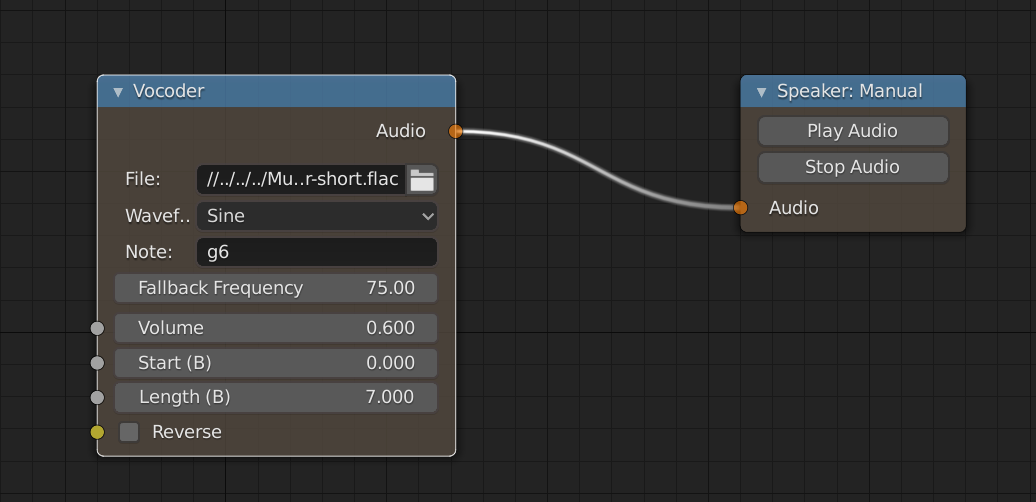

Update, Now we have a Vocoder:
It works on either an input Note, or Frequency. I have had such a large amount of fun playing with fart sounds and very low frequencies… :rofl: :joy: :cowboy_hat_face:

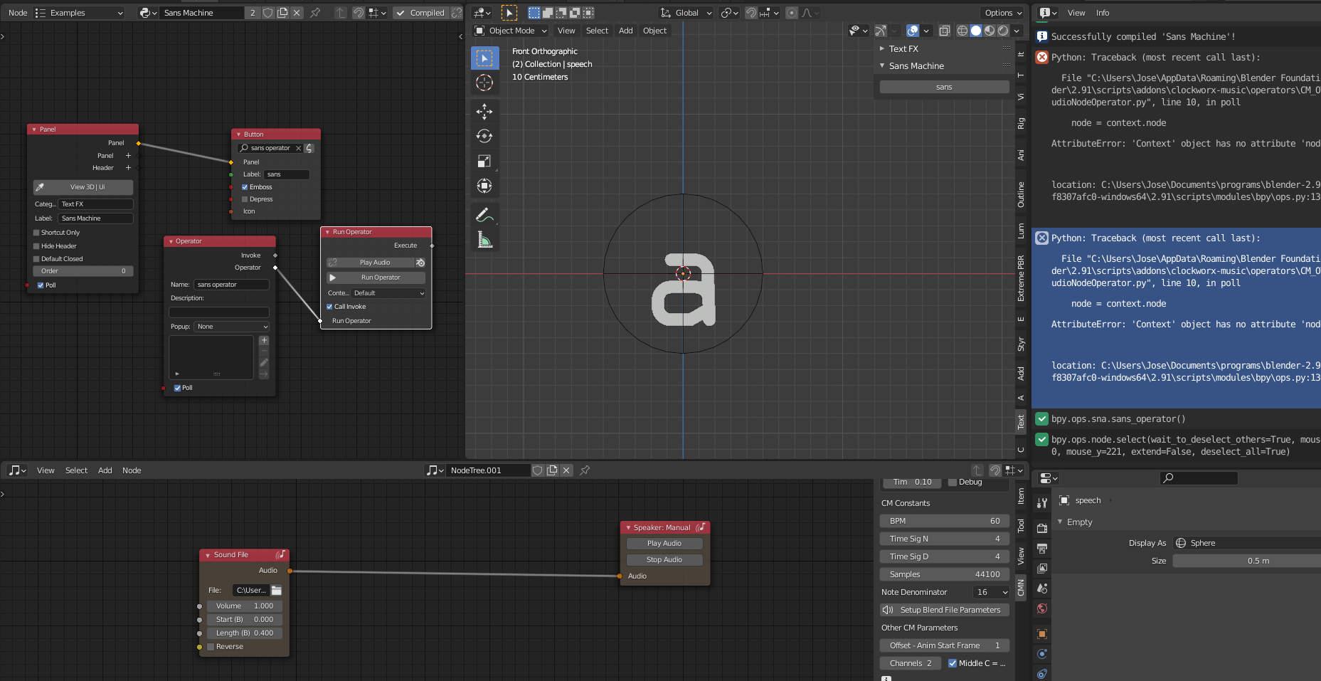

I’m trying to integrate clockworx with serpens, is there any way to use the “play audio button” outside of the context of the clockworx node editor? I made a button called “sans” that, when pressed, calls the “play audio” button in the clockworx node editor.
The big picture is that it’ll play the audio file repeatedly, but only while the text is updating, much like the way it’s done in games like Undertale or Banjo-Kazooie, which should make dialogue basically automated for me.
