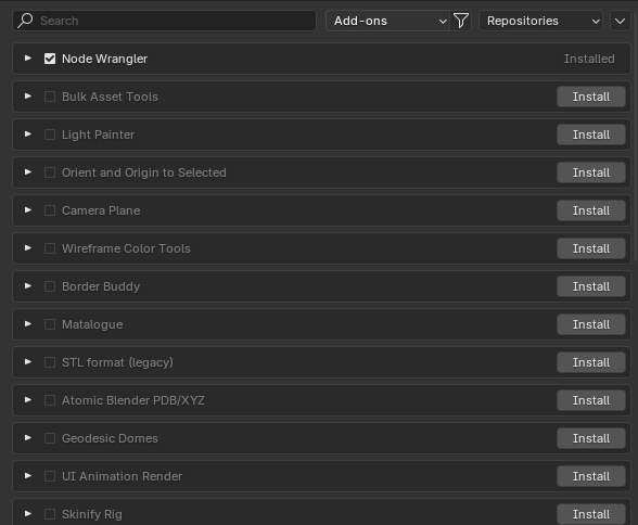

Not sure if this is the right place but I noticed that the extensions list (not sure why the name was changed from Addons to extensions…), is not in alphabetical order.
I really hope the decision to remove Node Wrangler, import image as planes, and Rigify from default blender is reconsidered. They are used in soo many tutorials and people expected them to become default blender features and to have them be made less available is sad news especially if it breaks people’s Blender setup when they update to 4.2
