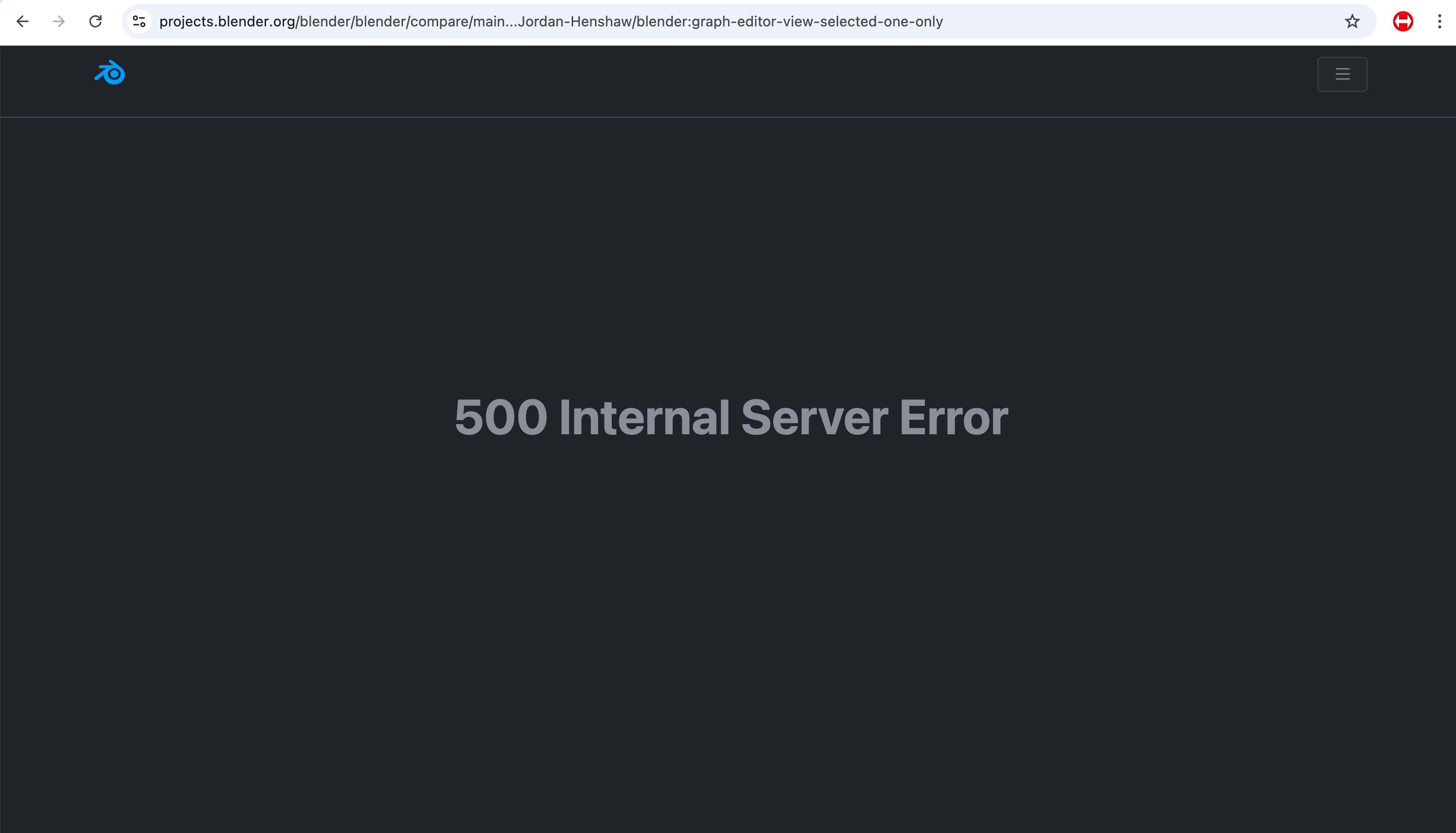

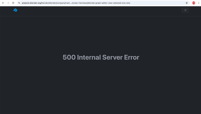

I’m not positive this is the place to post this, but I’m trying to make a Pull Request from a branch on my fork of the main Blender repo, but the thing gives me a 500 Internal Server Error screen every time I try. I’ve synced changes, it’s up to date, but any time I try to PR from any branch on my fork, it yells at me. It used to work fine a few months ago.
What have I done?
I can reproduce the problem by going to the URL: http://projects.blender.org/blender/blender/compare/main...Jordan-Henshaw/blender:graph-editor-view-selected-one-only
