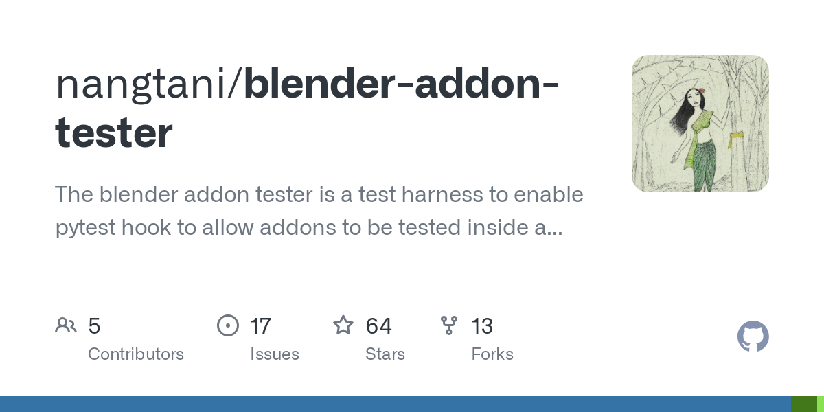

blender-addon-tester is a python module that you install to your system that allows you to write and execute tests for an addon using pytest.

blender-addon-tester currently does all those things.

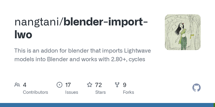

This is the upgraded lwo importer, runs against blender 2.78 through 2.83 (the nightly at the time of writing)

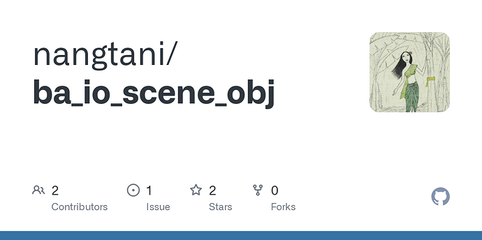

An this is another basic addon integration, however the addon is the importer for OBJ from the blender-addon.git repo, which has been added as a submodule to this repo. This allows some one to write tests against an addon which is in a repo they don’t have write access to.

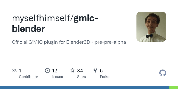

The tester is also being used over on the gmic addon for blender. @myselfhimself has been working on bringing part of the module up to snuff so that it is in a state that it could be checked into pypi.
