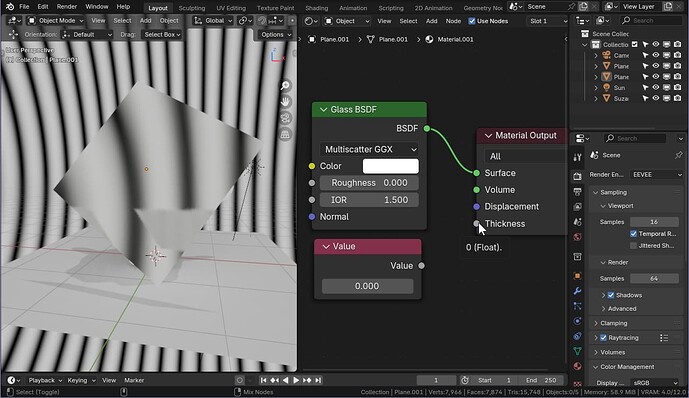

Hi, I don’t know if this is a bug or a known issue or expected behavior, but the Thickness input in Material Output is 0 by default, but if I input 0 to it using the value node, I get different results.
should I report this?
https://docs.blender.org/manual/en/4.2/render/eevee/material_settings.html#thickness
If no value is plugged into the output node, a default thickness based on the smallest dimension of the object is computed. If a value is connected it will be used as object space thickness (i.e. scaled by object transform). A value of zero will disable the thickness approximation and treat the object as having only one interface.
Thanks for the reply. I forgot to look through the manual, sorry.
Just my opinion, but I think it would be better to display just “Float” instead of “0(Float)” when hovering the mouse over the socket. I was confused on this point.
For example, the Vector Input socket of the Image Texture Node says “Vector” instead of “(0,0,0)(Vector)”.
I think seeing the value is very useful though.
In the texture node, the vector input isn’t a collapsed socket, it has clear, always-visible values associated with it, when nothing is plugged in
I agree that it is useful to see the value.
However, the fact that it says “0 (Float)” but actually contains a different value was a source of confusion in my case.
Although, I just notice that this may be off-topic because I found others that were not as intuitive when I looked at other Node sockets (e.g. Normal socket of Principle BSDF).
