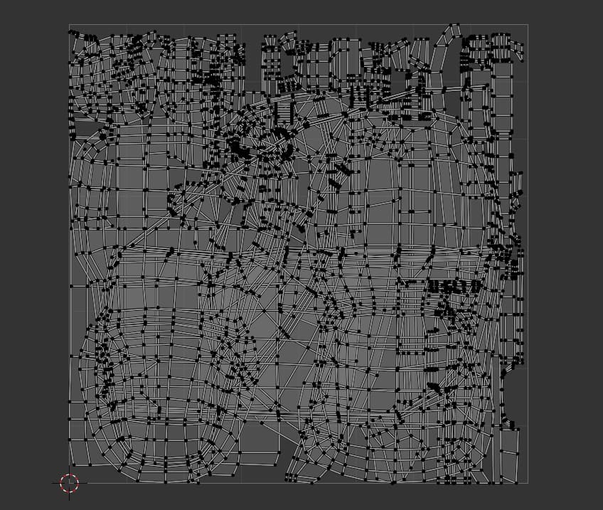

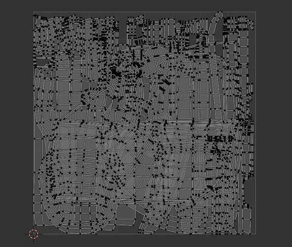

The important thing that the current un-synced mode does IMO is not selection related but actually visibility related.
If you have a model with multiple materials, and each material is unwrapped to its own UV space (common practice), having everything visible with sync select is very messy to work with.
Working this way, you have to hide and unhide parts of the mesh based on the material and it is all a lot of clicks (E.G. to switch from editing one material’s UVs to another: unhide, deselect all, switch to face select, select, select similar, hide). Turning sync select off was a decent way to manage visibility.

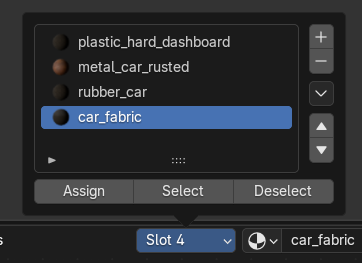

However, I think a better way to manage visibility is with an explicit visibility setting. My preference for the options to be:
  • All
  • Selected
  • Material Slot
But if it would be too much bloat to keep Selected around, then just an option for All or Material would be fine. If Material is chosen, it would just show the faces that are assigned to that material slot and there could be an active slot selector like there is in the Shader Editor.
But however it works out, I do think some option for managing visibility is needed so users don’t have to constantly select and hide parts of the mesh to make it usable in that common scenario.
