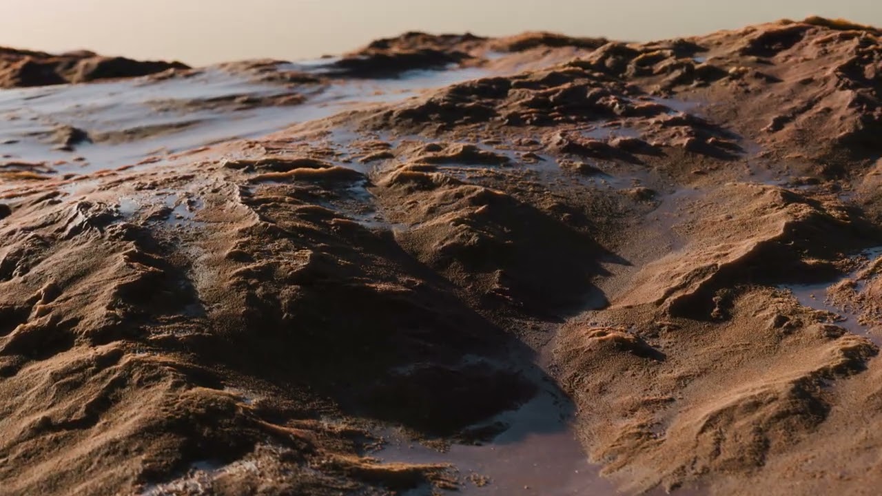

I am ecstatic that the experimental feature “adaptive subdivision” recently got motion blur support in Blender 4.5 Alpha. I don’t think anyone has really shown off how good this can look … Here is one of my test renders in Cycles using motion blur (at the default of 0.5 which is equivalent to a 180 degree shutter angle in a camera) with adaptive subdivision and a static dicing camera (the dicing camera isn’t moving and is just in an optimal position for the entire shot). This is a short 8 second video. Landscape made in Gaea 2.0, all rendered in Cycles in Blender 4.5 Alpha:
I look forward to adaptive subdivision eventually being polished and supported (I read that it is being worked on in previous meeting notes), but until then, I can use it in my work. Combined with the eventual texture caching / mip map system, Blender’s Cycle’s rendering engine will be (in my opinion) the best overall path tracing renderer out of them all. I love what everyone is doing here. Thank you so much :slight_smile:
