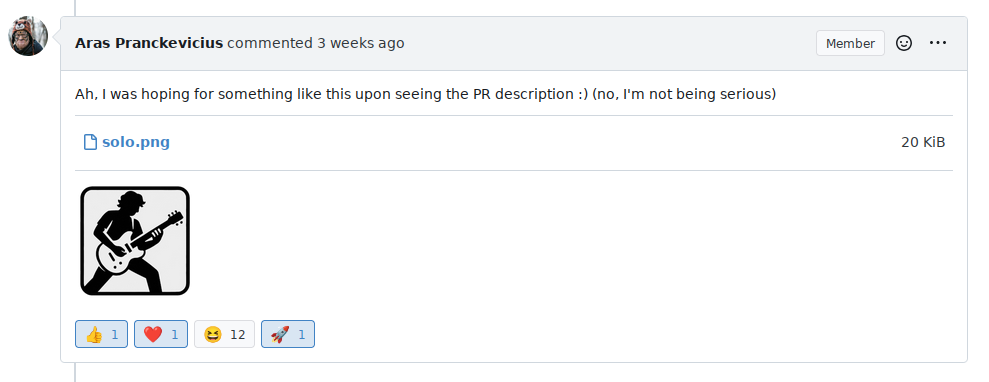

- Wants to share the new Solo icon: (#137014: UI: Solo Icon Change)
