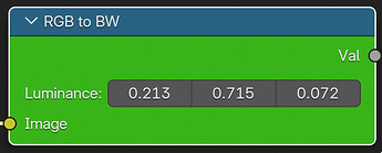

  • Custom RGB to BW conversion:
    • Decision: Exposing conversion factors are not valuable but exposing different ways of converting from RGB to BW can be useful (e.g. choose from luminance, average etc…).

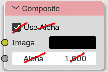

  • Remove alpha option from composite and viewer nodes:
    • Agreed. Will be removed in 4.5

So…will we still see the alpha (it’s just automatic), or not see it?

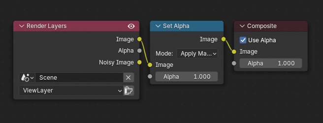

isn’t there a set alpha node?
1
Of course
As stated by Nahuel and Bobo, that option was basically just a Set Alpha node built into the Composite and Viewer node, but it is more limited and has some bad UX, that’s why we will remove it. Users can just use a Set Alpha node.
So if I want to see my objects with the transparent background, I’ll have to add additional nodes?
Seconded- how is having to make two nodes for what used to be one better UX than whatever is wrong with the current UX?
I might be wrong, but I’m pretty sure the alpha channel is implicitly carried along with the Image socket (or at least that’s how it works currently).
The Alpha socket is just for overriding that, which does seem a bit arbitrary to me.
That’s why I asked “what will I see”, not if there are other nodes that have something to do with alpha channels.
IE, when the checkbox is gone - is the alpha inherently now ON or OFF?
Ah ok, I’d assume that it would be inherently on then (though maybe not).
In that case, I think it does make sense to remove the checkbox and socket. Replacing the alpha channel is relatively non-standard, and doing it with a “replace alpha” node makes more logical sense to me than doing it in the output node. Having it in the output node seems a bit arbitrary.
@thorn-neverwake @josephhansen Just like @Strike_Digital said, the node will behave as if the checkbox is enabled. Whatever alpha your output have will be used as is with no adjustments.
Good news, thanks for clarifying that.
