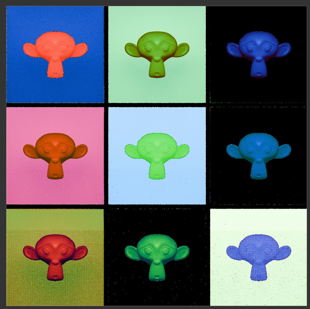

EDIT: pretty sure regardless of whether AO works or not, that the passes are wrong.
Combined (note the broken stuff)
Diffuse Direct (there seems to be little correlation between this and the Combined pass - the top left room only features red or white objects and light sources, and yet the direct light there looks blue on the red walls? Etc.)
Diffuse Indirect (similarly little correlation - also it looks like the weird sampling nonsense is contained entirely in the indirect passes)
Diffuse Color (this one seems correct)
Glossy Direct (this one seems fine)
Glossy Indirect (weird sampling issues aside, also fine)
Glossy Col (seems fine)
