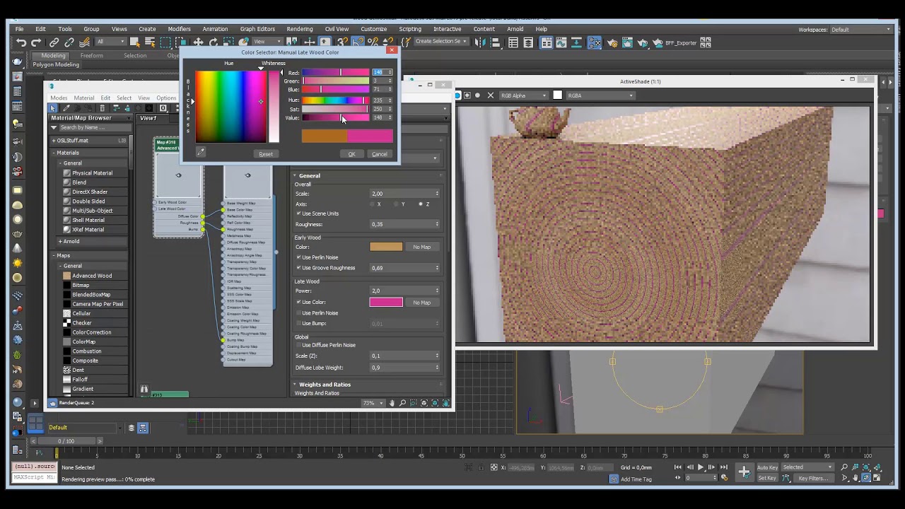

In addition, there are many very realistic material presets that were created for OSL. Take this procedural wood shader for instance (it was published by Autodesk, so it should be fine to link it here):
I would love to have these advanced materials available as well. @brecht are there any plans to bring OSL over to GPU rendering and have these OSL shaders available as default material presets as well?

Hello, I would like to see some of it within Blender like the Search Box, Uv Randomizer and Clipping Texture. In Max, Advanced wood does not connect automatically, it is manual, these are procedural textures nodes (in blender there are already, Wood’s is not) and not a procedural wood shader for instance as you mentioned.
